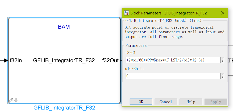

hello,
now  i am studying the demo of "VF_control_MP574xP"

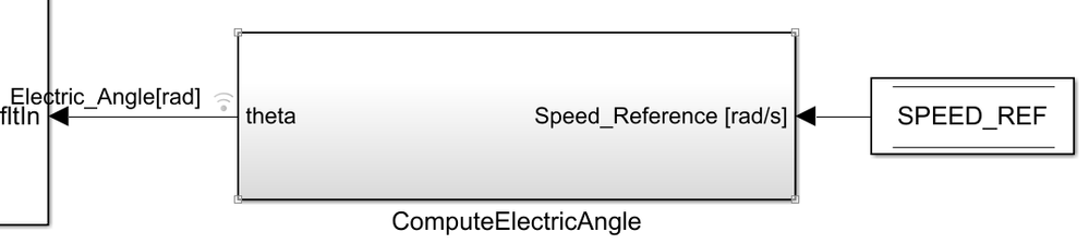

but , I have a question about the module"ComputeElectricAngle"
In this module, the f32C1 is configured with "(2*pi/60)*PP*Nmax*(C_LST/2/pi)*(2^31)"
the input of integrator is "Speed_Reference/(Nmax*(2*pi/60))"
the output of integrator multiply by pi is electric_Angle.

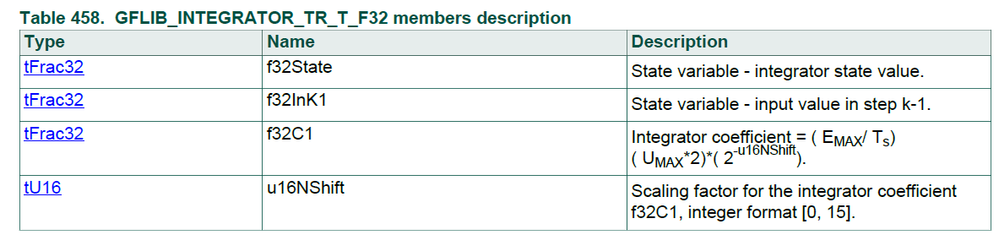

but the manul of the integrator is no same as above forms.
Could anyone help to solve my confuse?

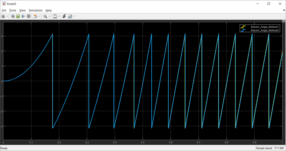

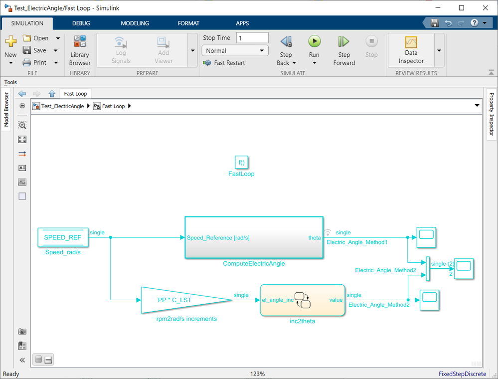

So, to come back to your questions: I'm using the integrator to perform a mathematical trick. I'm attaching a model below - which compares 2 methods of angle computation. Both methods are doing the same thing. But in code generation, the methods with AMMCLIB blocks will run faster due to the avoidance of expensive floating-point functions calls from the standard floating-point library (see this subject: How to Squeeze Every Last Drop of Performance Out of SIMULINK Models with AMMCLIB  )
The resolution fo the first method is better than the second - one of the aspects being the maximum speed that can be obtained with the motor. Instead of integrating the entire numerical domain, you can limit the range by specifying the maximum speed that your motor is capable of.
The f32C1 integrator gain is computed so that the integrator will manage 2 mathematical computations:
- transform rad/s -> rad by a simple gain.
- wrap around in +/- range due to the mathematical properties of additions on fixed-point calculations.
In fact, the second aspect - the wrap-around is what interested me the most, because then I can just convert the integrator result to a float number in the range of -1:1 and simply multiply it by pi. This way I know for sure is not going to feed wrong data into the sine/cosine function.
