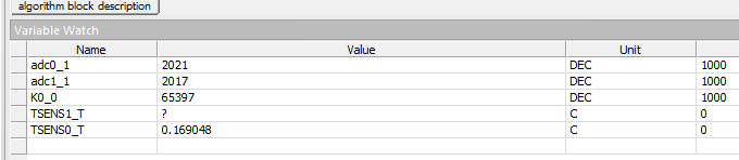

abhishek_kumar1
mariuslucianandrei
Please see what I get in Freemaster (below snapshot)
Mostly I get 0.16 degree Celcius. Which seems to be a bit odd.
The files you sent had incorrect channels selected in them for ADC so I edited the file a bit :smileyhappy:. Hope its okay.
I have attached the files.
Thank you for help.

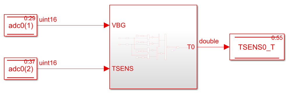

mariuslucianand
Hello abhishek.kumar@chassisbrakes.com‌,
I finally managed to find what's wrong in your model.
1. In the ADC Config Block it has no influence the order of the channels, because in the result the refPMC will be the first result and the TSENS will be the second result. The results are ordered after the channels number this case AN10 and AN15.
2. After that I've compared the raw ADC outputs from your model and mine. The raw values were the same so the problem was in the conversion formula, which was modified that the one from the model attached. So I've found two things: The first one is that the inputs for the Conversion Subsystems were reversed: refPMC with the TSENS, and this is the reason why I started with a little explanation at the first point.
The second reason is that one gain for the formula was applied only on the second member of the sum and not for the entire sum. In the following screenshot I've highlighted the old position vs the right one.
I've also added the Kelvin to Celsius conversion for the Temp0 and this is the FreeMaster screenshot. I've also attached the model with the TSENS0 formula changed and the FreeMaster project too.
Hope this helps you!
I'm waiting for your reply!
Marius

abhishek_kumar1
Dear mariuslucianandrei
It works now.
And thank you for letting know the that data stream is arranged based on channel number.
Best Regards
Abhishek
