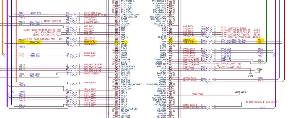

Hi Mikel,
Unfortunately i do not have your hardware available for me to try so the only thing i can do for you is a schematic analysis.
#1: according with TWR-MC-LV3PH http://www.nxp.com/assets/documents/data/en/user-guides/TWRMCLV3PHUG.pdf  Table 5, the hall signals go PCIe Tower System PRIMARY connector on A33/A34/B34 as TMR0/1/2.
#2: according with TWR-KV31F120M schematics http://www.nxp.com/assets/downloads/data/en/schematics/TWR-KV31F120M_SCH.pdf these TMR0/1/2 are routed to PTA13/PTA12/PTD6
Can you please modify your Simulink GPI read model to read hall signals from PTA13/PTA12/PTD6 sources. Does it shows all hall transitions ?
Hope this helps!

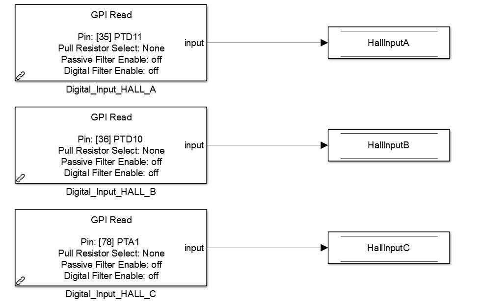

I have attached the image with the signals I get to the first message.
It's clear that something is not right.
Thanks for your help,
Mikel

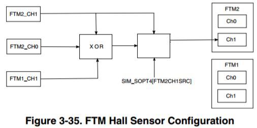

mikelgodoy
Hi Daniel,
Yes, it shows all hall transitions reading PTA13, PTA12 and PTD6.
The problem was that when using input edge capture block, FTM2 only lets to configure PTB18 and PTB19 pins in capture mode.
PTA12 and PTA13 can be configured in FTM1, but it is not possible to set PTD6 in capture mode.
This solved my problem, thank you very much!
Mikel.

Daniel_Popa
Hi Mikel,
Just for the records, what you are pointing as functionality is a special mode of FTM operation that is designed to offload the CPU computation for motor speed and position.
To take benefit of it you need to design your custom board to feed the hall signals to that particular input pins.
The devkit you are using are built to be generic and to pack as much functionalities as possible in a small footprint.
