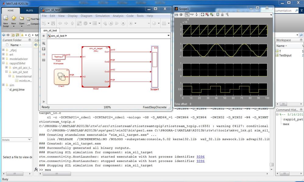

Hello everyone,
        No matter which version or complier is used,it seems that the same problem always happened.I have no idea to  solve it.Can someone help me about it ?Please review the attachment.
Thanks a lot.

Daniel_Popa
Hi Hj,
From your error file it looks like your MATLAB installation is in a path with " " _spaces and that seems to trigger the error.
sim_sil_target.mk:173: E:/Program: No such file or directory
sim_sil_target.mk:173: Files: No such file or directory
sim_sil_target.mk:173: (x86)/MATLAB/R2013b\rtw\c\tools\lcctools.mak: No such file or directory
gmake: *** No rule to make target `(x86)/MATLAB/R2013b\rtw\c\tools\lcctools.mak'
What i suggest is to:
- reinstall MATLAB in a path without spaces: e.g. C:\MATLAB
- use Microsoft Software Development Kit (SDK) 7.1  to get the compiler: Download Microsoft Windows SDK for Windows 7 and .NET Framework 4 from Official Microsoft Download C...
With this setup it should work flawless:
My setup: Win7 + Matlab2013b + MSDK7.1
Hope it helps!

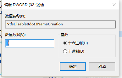

hjhjhj
Hi Daniel,
    Firstly,I configured this computer and enabled the 8dot3 on E partition as follow.But it didn't heip.Is it the rightway to configure it ?
    What's more,I want  to know the way to use MCToolbox when  MPC5643L working on DPM mode.
Thanks a lot.
    Hj
