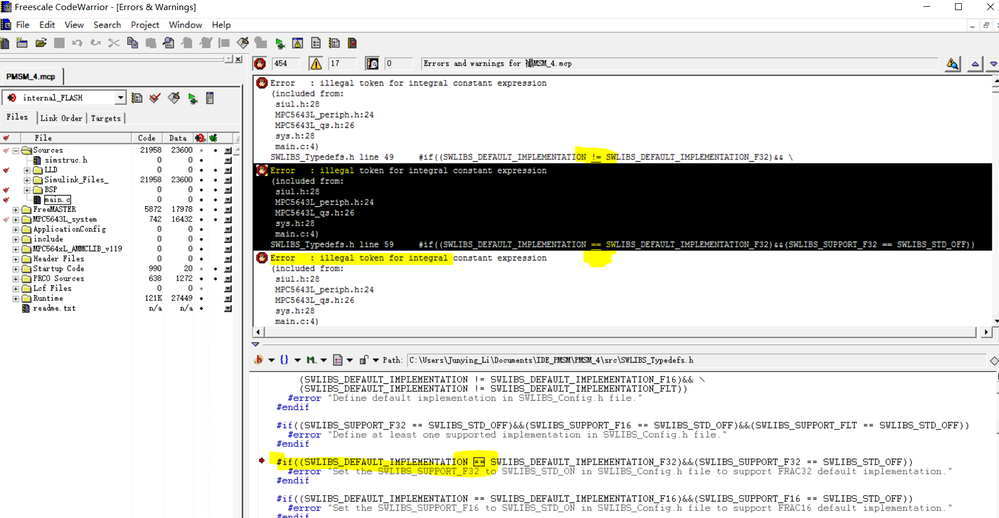

Now I found the software of S32 Design Studio for Power Architecture v1.2 has some error,So i wanna transplant the dual motor control S32 project(http://www.nxp.com/downloads/en/apps/MTRCKTDPS5643L_SW.exe ) to Codewarrior IDE project,but i come across some error,and i do not know how to solve it?
the Error shown as below:
ALL the error is the same.
the Attachment is the my project.

Regarding the old IDE (which i honestly don't know how to use it) i seems like you need to add a define like this
SWLIBS_DEFAULT_IMPLEMENTATION=SWLIBS_DEFAULT_IMPLEMENTATION_FLT
This is how you do it in S32DS but i do not find a way to add in CW IDE.

I import the S32 dual motor project from NXP,but has the Error
Friend, Can you help me?
