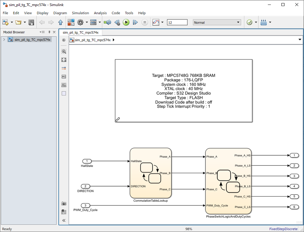

The following model is the target model, the one which will run on the MCU. Here you can see that it contains the config block, and the program that it will execute.

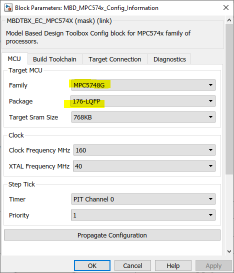

What is it important here is the config block. Here you need to select the target mcu type, package and sram size. Obviously you need to select in the Build Toolchain the compiler you want to use.

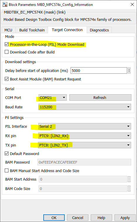

Target Connection tab is the most important one when it comes to PIL. You need to select the PIL Download mode.
The Serial subsystem provides the computer port on which the board is connected. For me, the board was linked to COM21, but it will choose another board on your PC. The baudrate represents the speed used for board flashing. Before you run this, you need to program the board with a bootloader. This means that you need to open Design Studio for PA and flash the right rbf for your board. You can find the rbf in the toolbox installation under the following path src\tools\BootLoader\RBF_Files.
The Pil settings represents the board Serial on which will communicate with the host PC. I used the MPC5748G-DEVKIT and the settings are Serial2 PC8/PC9.

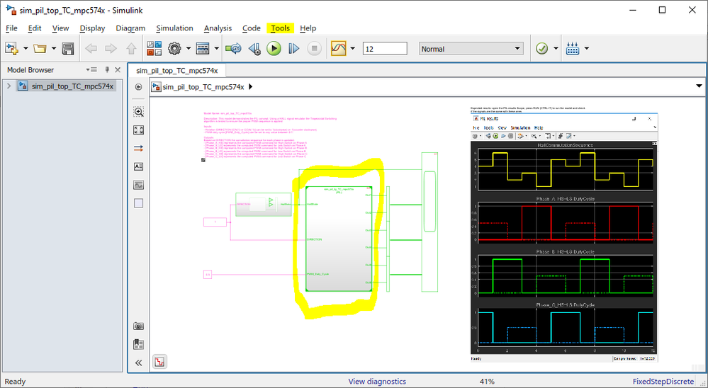

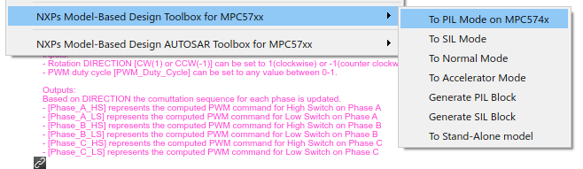

Go back to the top model, and if you are working to a new model, you need to set the referenced model to PIL mode. For the model attached it is not necessary, because I already did that. To set, you need to select the referenced model, go to Tools and select, as in the image, 'To PIL Mode on MPC574x'.

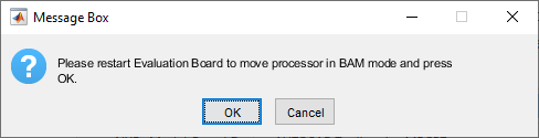

All this been set, now you need to run the code. Press the 'RUN' button and wait to generate and build the code. When the code has been compiled, a window will appear. Now you need to reset the board and press the OK button.
The bootloader will erase and flash the board. After this process is complete. The code will be run and the data transferred back to the host.

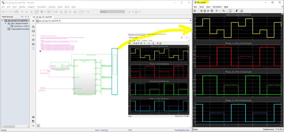

When the process is complete, if you open the Scope, the same results as in the attached image will be displayed.
