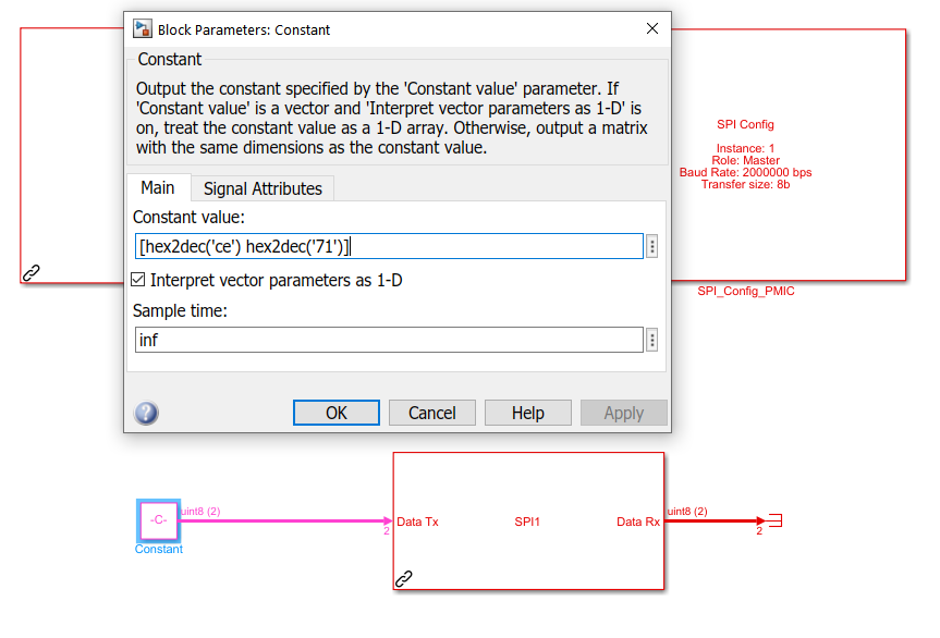

constantinrazva
Hello [email protected],
When using the 2 constant blocks and 1 mux (like in your example), I was able to reproduce your error. What happened in this case is Simulink coder saw that variable as if it was only 1B instead of 2B. I was able to get the desired output on SPI using a constant block, as shown in the image below (using an array of 2 uint8_t variables, 0xCE and 0x71).
This is the output I am getting:
I am transmitting 0xCE71 in 1 transfer, using the following options:
Note that the MOSI is still going up (at about 1.8V) for ~0.12us, but due to the sampling of data being done on the trailing edge of the clock, this does not impact the message. This issue will be sorted out with the SDK team - when they will have reached to a conclusion I will let you know.
Also note that this has been done with the PEBRIDGE set to 50MHz (but no notable difference versus the old configuration).
Kind regards,
Razvan.

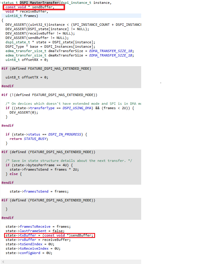

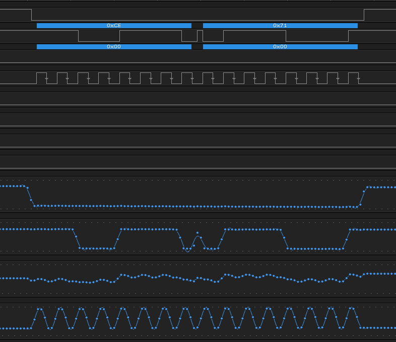

Hello constantinrazvan.chivu, ‌ adriantudor‌ and mariuslucianandrei‌
Using the Frame Size configuration = 8 with Continuous Transfer to send some "Read Command", I still get some response via SPI (As already stated previously for the SPI Device ID message).
However, when I try to send some "Write command", I directly get an error.
As example I am trying to send the WD_WINDOW command to configure the watchdog window duration to 12 ms (SPI output message 0xCE71).
Watching the SPI_Output on oscilloscope, it seems to be sending the message 0xCE00 (What causes a SPI error):
By checking the generated code, the DSPI_MASTER_TRANSFER function sends the SPI output when called.
Function Call:
Local Variable:
Values in memory:
I believe some problem is going on.
I imagine that the bytes of the command 0xCE71 shall be placed consecutive in the memory in order to send the data to the SPI transmit buffer.
What do you think?
Please let me know a solution as soon as possible.
Regards, Rafael

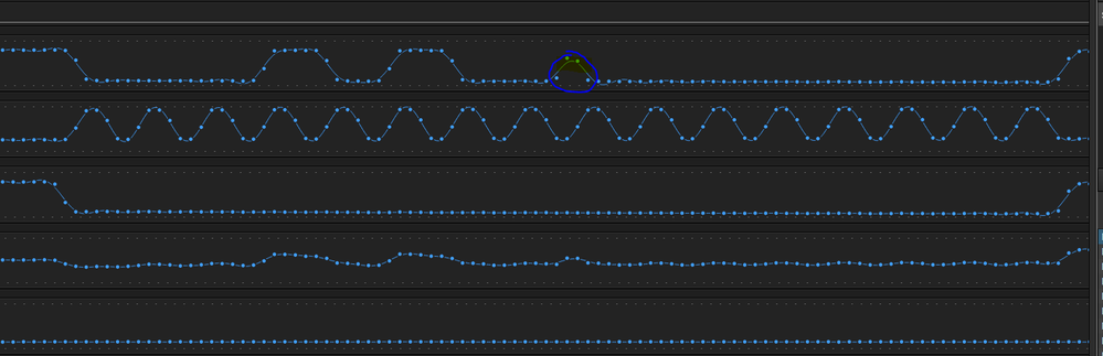

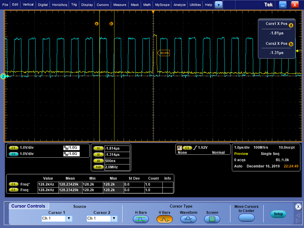

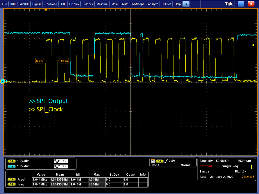

rafael_barbosa
Hello constantinrazvan.chivu‌,
Indeed the configuration is 16 bits and the transmit is a mux with two sets of 8 bits.
But I had to use this approach because the SPI Transfer block just accept uint8 input datatype.
Also I tried to run the example with the configuration frame size 8 and continuous transfer
but still there is a unexpected behavior in the SPI output, as you can see below: The SPI message is 0x1400. There is a unexpected step (the last one).
Also you can check the strange clock behavior during the transmission on the below picture:
Kind Regards, Rafael

constantinrazva
Hello [email protected]‌,
I saw the rest of your messages after I posted my last reply - I saw that in my own example as well - that is indeed strange.
In my case it goes to around 2V4, so it does not reach ~3v2 as the valid data does. adriantudor‌ suggested that it might be due to MOSI pin being undriven for a small period of time, while having a pullup. This can cause the pin to start going up, then the SPI starts driving it again. I will investigate this behavior, but in your case, having the clock phase set to the trailing edge (2nd edge) and the clock polarity to active high, that part of data will not be sampled (so it is read as '0' even though the logic analyzer clearly catches it).

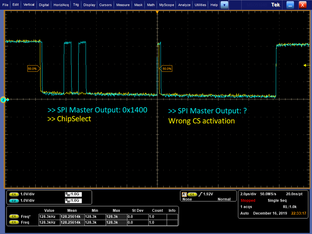

rafael_barbosa
Hello, I would like to share some screenshots that show out what is the behavior of Chip select, Clock and SPI Output for the model sent attached on previous message
From my understanding the output of CS has a wrong activation after sending the message.
Probably it is causing error when reading the message.
Can anyone support me with it?

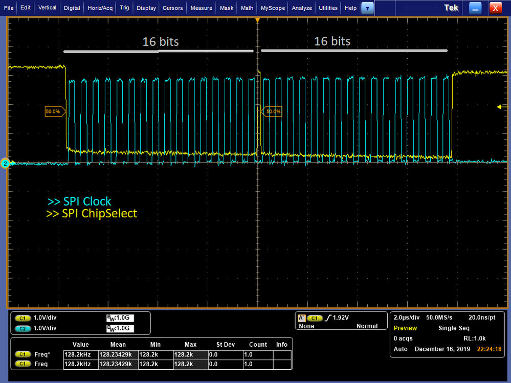

constantinrazva
The SPI Transfer block sets the transfer size equal to the width of the input signal. Simulink mux block outputs uint8[2] signal, so it is actually setting the transfer size to 2, thus the signal you get (2 x transfer size, with CS being reactivated between the 2).
I will give you a model that will generate the signal that you are looking for.
Kind regards,
Razvan.
P.S.: Thank you adriantudor‌ for the help on this matter!

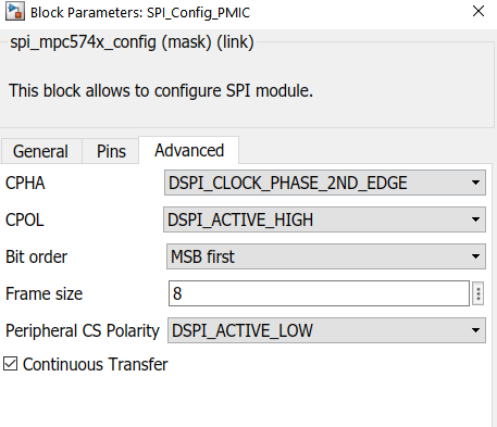

constantinrazva
So the easiest way (minimum of change to your model) would be to change the SPI settings from the SPI Config block. Set
frame size = 8
and enable
Continuous transfer
to get the following signal:
Let me explain why these settings: on one hand, you'll have transfer size set to 2 (due to usage of MUX block); on the other hand, you want to send 16bits. Given this context, you can only set the frame size to 8. After you have these settings, you only need to enable continuous transfer so that you don't have the CS go HIGH in the middle of the 2 bytes.
There are other ways for achieving the same end result, but being necessary to change more blocks in your model, I don't see it become relevant.
The easiest way in managing any kind of SPI transfer is by using 8bit frame size with cointinuous transfer enabled and making sure you give the SPI T'ransfer block an input of appropriate size (the transfer size you need).
Please let me know if you have other questions regarding this subject.
Kind regards,
Razvan.

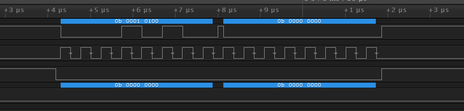

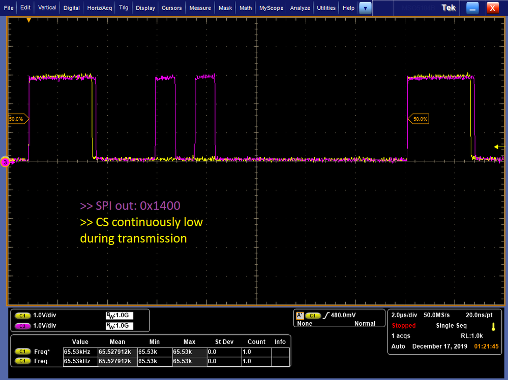

rafael_barbosa
Hello Razvan,
Thank for the response.
The target is to read a simple SPI message of 16 bits size using the MBD.
Below you can see a correct message output using the example from S32 Design Studio (direct C code).
Kind Regards, Rafael Barbosa
