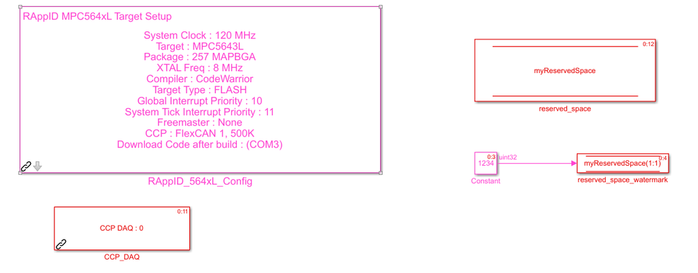

There are at least 2 methods i could think of right now:

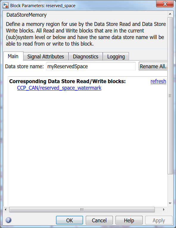

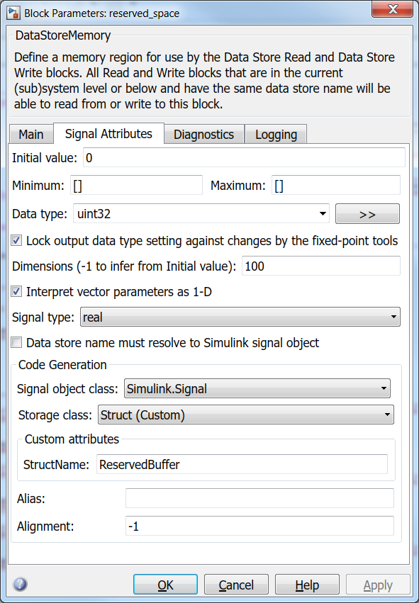

- #1: quick in and dirty is to declare a reserved buffer in Simulink with a size you control. Since in Simulink you control the read/write into such buffer you could easily implement what you want with writes and reads to any specific index in the buffer.
Am saying is a quick and dirty since you do not control the start address of the buffer - depending on your Simulink modification that might change and you might need to re-adapt the start address of the DataMemWrite/Read Blocks (the offsets remains unchanged). If you use instead DataMemWrite/Read the standard Simulink Read/WriteStore blocks - then everything would be ok and you could forget about address changing due to adding new stuff in the model.
How to declare a 100 uint32 size buffer called myReservedSpace in Simulink:
How to implement the model

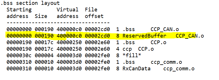

How to check the memory allocation:
