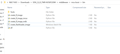

You cannot build an flashloader image from Simulink. But you can find the need files/scripts for this in the SDK of the TRW-KV5x board. You can download the full from nxp site: https://mcuxpresso.nxp.com/en/builder?hw=TWR-KV58F220M
And in SDK_2_8_0_TWR-KV58F220M\middleware\mcu-boot\bin you can find some scripts to create a new flashloader and also in Tools the Kinetis Flashing tool.
