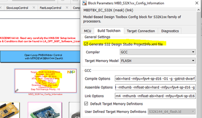

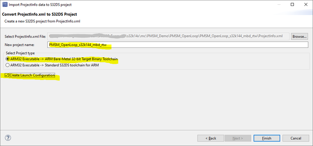

How do you import the project in S32DS? On my end, I've tried to import the generated code for the PMSM_OpenLoop_s32k144 model and I am able to build the generated code. Let me explain the steps:
1. Make sure that the Simulink model has the "Generated S32DS ProjectInfo.xml checked in the Config model.

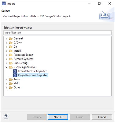

2. Go to S32DS for ARM 2.2 go to File > Import, and under S32 Design Studio check the ProjectInfo.xml Importer
3. In the newly opened window, please select the ProjectInfo.xml file from the generated code, and make all the below checks.
4.Once the import process has been completed, open the PMSM_OpenLoop_s32k144.c and you should now able to build the project.
In my console log, you can see that the project has been successfully built and now you can go to the Debug configuration and start debugging the code on the board.

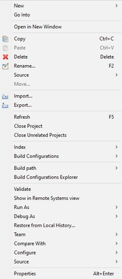

I am doing the same thing as you bug after I import the project I get a message in the console saying "corrupted build tool for project : [project name]"
In addition I don't have the build option when I right click the project after importing

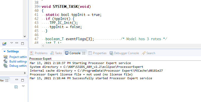

This is my output of the Console log when I import the generated code into the S32Design Studio.

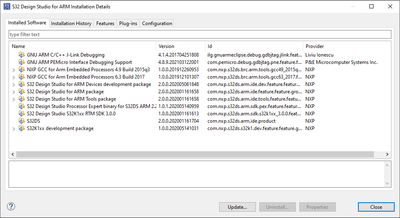

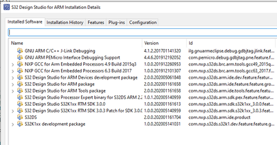

Maybe the issue is from S32DS. Can you please show me the installation details of the S32DS for ARM? Go to Help > Installation Details.
I wonder if you need to install the S32 Design Studio for ARM 2.2 Update 1 S32 SDK for S32K1xx SR RTM 3.0.3
To show enable the build button please open one of the sources from the newly imported project. Can you please also attach the console log output error from from the build process?

ruihang_wu
Here is the installation details window. I am still running version 2.2

RajG
Below is the installation details of the S32DS for ARM:
I have also open file still build button doesn't shows up and console log output error is still similar to what I attached earlier I will again attach that same file.

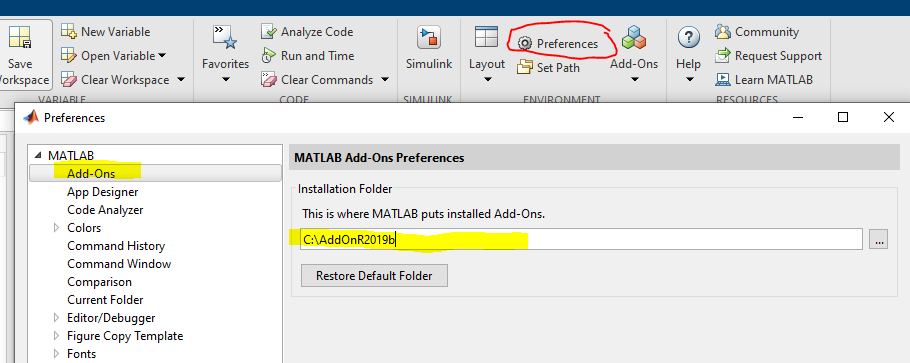

I had a look at the generated code once again, and the only difference that seems to have a connection with the fact that the Build button is missing is that some of the links from the Project.xml have some spaces.
From the attached example, I see that the toolbox is installed in the \AppData\Roaming\MathWorks\Matlab Add-Ons\ ...
I think the only way in which you can solve this is to install the toolbox in a path which contains no spaces. The easiest way is to uninstall our toolbox, go to Matlab ->Preferences -> Matlab -> Add-Ons and type a path with no spaces. Then reinstall again the MBDT toolbox and you will be able to import and build the generated code. For the best results, please use paths with no spaces for the model generated code folder as well.
