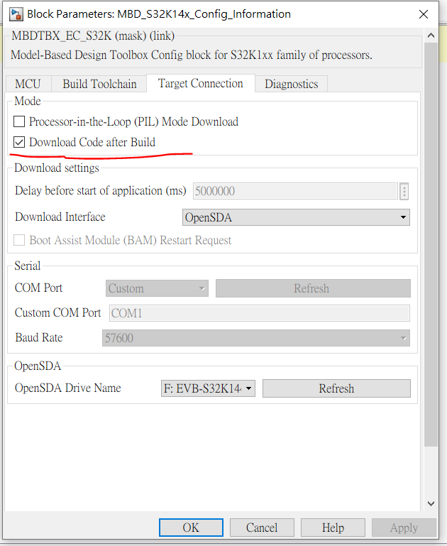

Hello
In Matlab simulation environment.
I plan to use microUSB to update the model of S32K144EVB.
I updated a few examples,and there are no errors in the diagnostic viewer.
But EVB is unexecuted the model.
Could you give me some instructions? please
Two target connection settings are used(attachment:1.GPIO LED Blink(COM9).PNG & 2.GPIO LED Blink (OPEN SDA).PNG)
Installed the driver(attachment:3.DRIVER.PNG)
EVB appearance(attachment 4:.EVB.jpg)

Hello @chen2021 ,
Can you please check if the Download Code after Build option is checked?
Hope this helps,
Marius

chen2021
@mariuslucianand
Hello Marius
Thanks for your reply.
Yes, it has been checked, but still unable to successfully update the model to EVB.
Setup screenshot as attachment

mariuslucianand
Hello @chen2021 ,
Can you please try to copy paste manually the .mot file form the generate folder to the mounted disk drive of the board? Maybe the OpenSDA needs an update on the board as described here https://community.nxp.com/t5/S32-Design-Studio-Knowledge-Base/HOWTO-Update-OpenSDA-Firmware-on-EVB/t...
Hope this helps,
