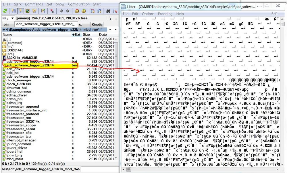

How to create bin/hex/s19 file using the MBD tool for S32.

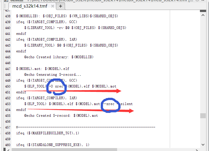

It depends on which compiler you are using.
If you are using GCC you need to replace line 450
$(ELF_TOOL) -O srec $(MODEL).elf $(MODEL).mot
with
$(ELF_TOOL) -O binary $(MODEL).elf $(MODEL).bin
For GCC you have the following options:
srec     Save as Motorola S-records
   $(ELF_TOOL) -O srec $(MODEL).elf $(MODEL).s19
binary  Save as raw binary
ihex     Save as Intel hex
   $(ELF_TOOL) -O ihex $(MODEL).elf $(MODEL).hex
If you are using IAR you replace line 453
$(ELF_TOOL) $(MODEL).elf $(MODEL).mot --srec --silent
with
$(ELF_TOOL) $(MODEL).elf $(MODEL).bin --bin --silent
For IAR you have the following options:
--srec          Save as Motorola S-records
   $(ELF_TOOL) $(MODEL).elf $(MODEL).s19 --srec --silent
--ihex          Save as Intel hex
   $(ELF_TOOL) $(MODEL).elf $(MODEL).hex --ihex --silent
--bin            Save as raw binary
ATTENTION: Lines 450 and 453 should start with a tab.

powerpc-eabivle-objcopy
If you want to automate it put it in the _make_rtw_hook.m callback.

用MBD工具箱生成的elf文件,然后下载到板子上。现在我想知道怎么设置,能够生成bin/hex/s19文件~~~

The easiest way to achieve your goal is to modify the default settings in the mbd_s32k14.tmf file within c:\MBDToolbox\mbdtbx_S32K\mbdtbx_s32k14\mbdtbx_s32k14\ folder
This file is responsible for generation the makefile used to build the model.
Inside the file, there is already a default example about how to generate a SREC from the elf. Therefore is a simple as changing the extension and the type of file you want to obtain: bin/hex/s19 etc since the toolchain is defined already.
Step1: search for any occurrences of ".mot" keyword
Step2. replace with the ".extension_you_want_to_obtain"
Step3: find the invocation of ELF_TOOL
Should look like this:
$(MODEL).mot: $(MODEL).elf
@echo Generating S-record...
ifeq ($(TARGET_COMPILER), GCC)
endif
ifeq ($(TARGET_COMPILER), IAR)
endif
ifeq ($(TARGET_COMPILER), GreenHills Multi)
$(GSREC_TOOL) -auto -o $(MODEL).mot $(MODEL).elf
endif
@echo Created S-record: $(MODEL).mot
And replace it with something like this:
Hope it helps!
