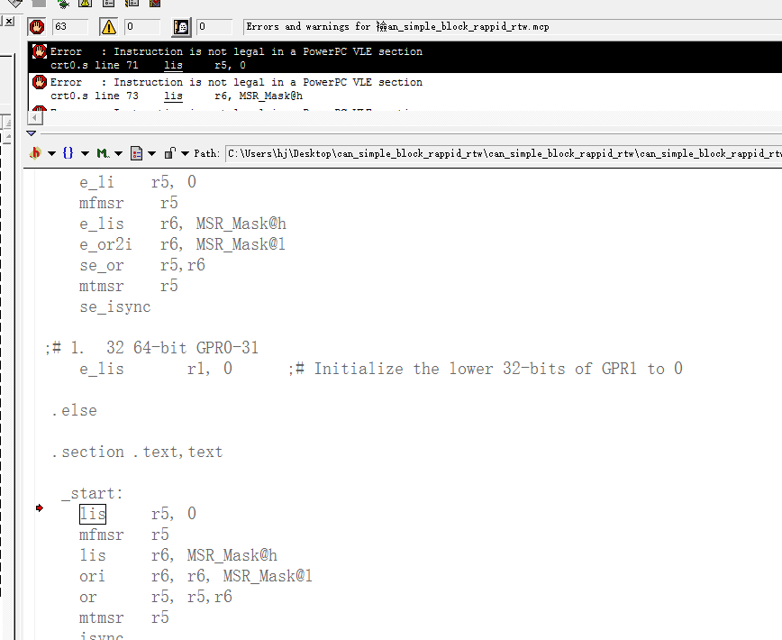

Hi hjhjhj‌,
I presume the compilation works fine with the Toolbox but fails when you try to reuse the files in the CodeWarrior right ?
A first observation - it looks like in CodeWarrior you are using a different startup file than the one used by the Toolbox.
In the toolbox generated files i see in crt0.s that the actual code is:
 _start:
e_li r5, 0
mfmsr r5
e_lis r6, MSR_Mask@h
e_or2i r6, MSR_Mask@l
se_or r5,r6
mtmsr r5
se_isync
Are you sure you have configured the CodeWarrior project correctly to use all the files from the Toolbox generated code and all the compiler/linker flags that the toolbox is using ?
Hope this helps!

Daniel_Popa
Hi hjhjhj‌,
I looked over this - but i'm afraid we will need to ask this question to the CodeWarrior community.
What i noticed is that CW does not take into consideration the macro VLE_IS_ON for the assembly
# Set the MSR[SPE] bit so code can use "evmergelo" instruction.
.equ MSR_Mask, 0x02000000
.ifdef VLE_IS_ON
.section .text_vle,text_vle ; The "text" generates symbols for debug
_start:
e_li r5, 0
mfmsr r5
se_or r5,r6
mtmsr r5
se_isync
;# 1. 32 64-bit GPR0-31
e_lis r1, 0 ;# Initialize the lower 32-bits of GPR1 to 0
.else
.section .text,text
_start:
lis r5, 0
mfmsr r5
lis r6, MSR_Mask@h
ori r6, r6, MSR_Mask@l
or r5, r5,r6
mtmsr r5
isync
.endif
If you remove/comment out the .else part it seems to work.
The toolbox is using this these macros:
ASSEMBLY_TOOL_OPTS= -vle -DVLE_IS_ON $(TOOL_OPTS) -list -gccincludes -nostdinc to it cleary needs to by specified via CW too - but i can't find any places to add this to the CW ASSEMBLY via IDE.
Hope this helps!

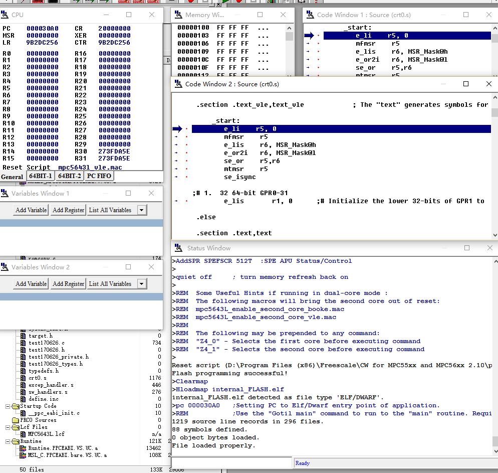

hjhjhj
Hi Daniel,
     I have added all the files to the project ,but it seems that there 're still other errors.Can you help me solve it ?111.PNG1.PNG
Thank you!
Hj
4,386 Views

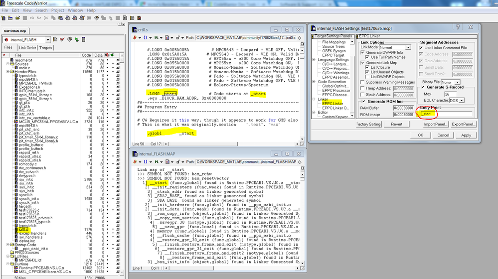

Daniel_Popa
Hi hjhjhj‌,
Glad to see you managed to build the project.
Looks like you are now able to enter in debug. From your screenshot and the map file you have generated, i think the problem is related with linking against a different start symbol defined - most likely the default one from the library *.a
In the debugger it shows __start while the crt0.s entry point is _start (one _ instead of _ _ )
I can't test momentarily the generated elf on the real HW but can you please do the following modification in your project and test it again. Basically you need to tell the linker to use the _start symbol defined in the crt0.s file.
Hope this helps!
4,386 Views
hjhjhj
Hi Daniel,
     The linker can identify the entry point now,but  I guess it stops somewhere and the project does not run.Do you konw the reason?
Thank you!
Hj

Daniel_Popa
Try to run step by step (instruction by instruction) and see where it stops.
4,386 Views

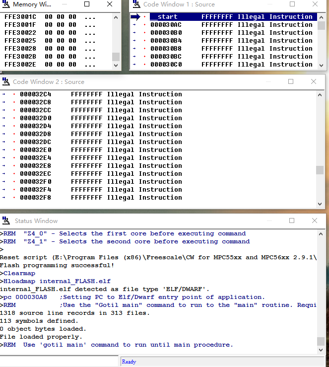

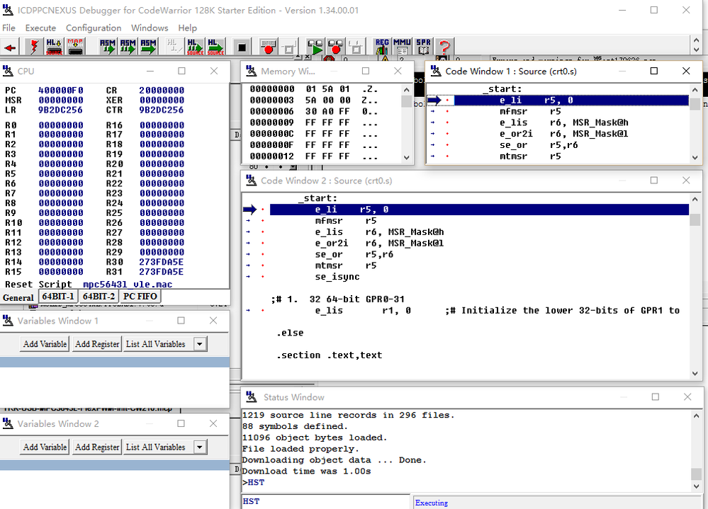

hjhjhj
Hi Daniel,
    When running on Assembly Level step,the project runs in the code window but only PC register runs in the CPU window.While on Source step ,the project stops as the screenshot shows and  only PC register runs .
Thank you!
