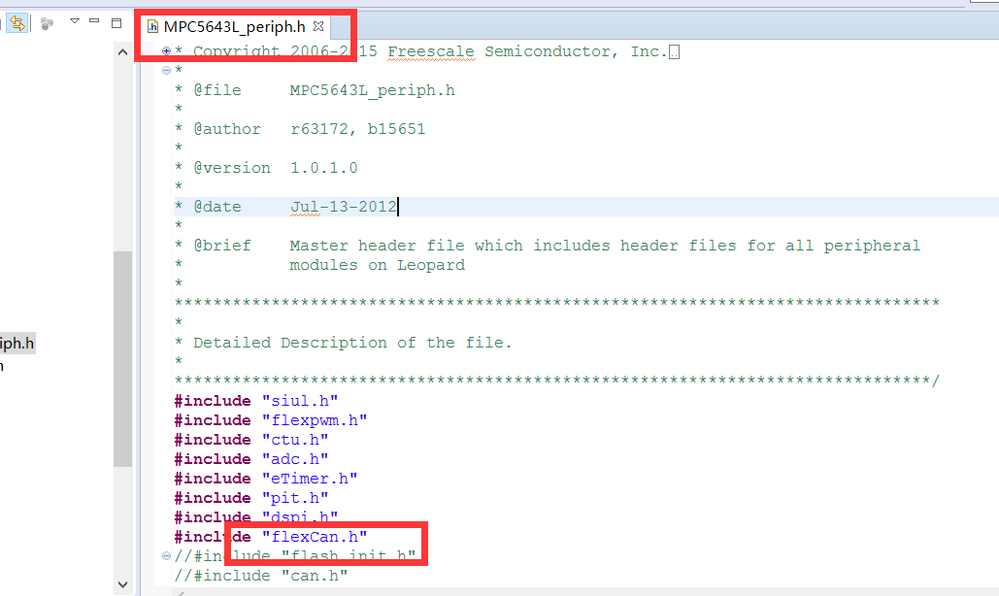

2#,
add the header file to the MPC5643L_periph.h shown as below:
* Detailed Description of the file.
#include "siul.h"
#include "flexpwm.h"
#include "ctu.h"
#include "adc.h"
#include "eTimer.h"
#include "pit.h"
#include "dspi.h"
#include "flexCan.h"

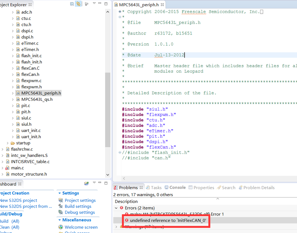

But there are some error popup,shown as below:
The tip seems said that  undefined the initFlexCan_0,but i clearly define the function in the  flexCan.h and  flexCan.c
I don't konw how to deal with it,The attachment is the S32 project.

Hi edenli‌,
I managed to reproduce your issue and fix it - but i have no explanation for this behavior (you might need to ask the guys from S32DS Community)
So, how to fix it:
#1: Change the FlexCAN.C into FlexCAN.(looks like the *.C is associated with C++ source files)
#2: delete the Debug folder and use Clean Project command to remove any other intermediate files
#3: Build the project and it should work fine now that all the source file are with "*.c" extension
Hope this resolve your issue.

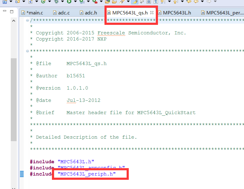

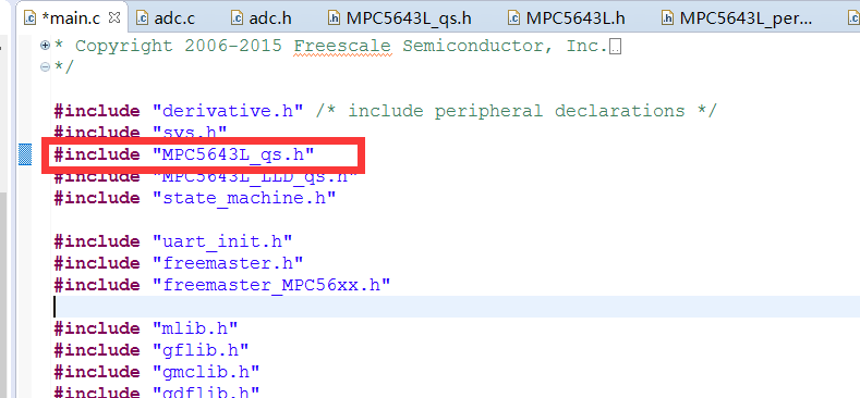

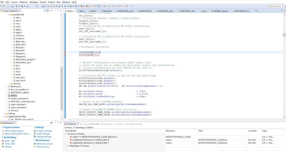

edenli
Contributor V
Hi Daniel,
the header file FlexCan.h is included in the file MPC5643L_qs.h
and then
next:
So the flexCan.h include in the main.c
but  still has the error:
How to deal with it,Daniel?

edenli
Contributor V
Hi Daniel,
Thank you for your reply!
Next,The question about the S32 ,i will realse to theS32DS Community,Now i solve the question
Best Regards!
