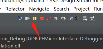

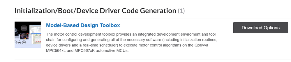

I bought a Devkit-MPC5744 recently, and downloaded the Model-based Design Toolbox for MPC5744P from the NXP website.

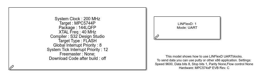

And then I open the example model file from the Model-based Design Toolbox. The model is "uart_model_pnt".

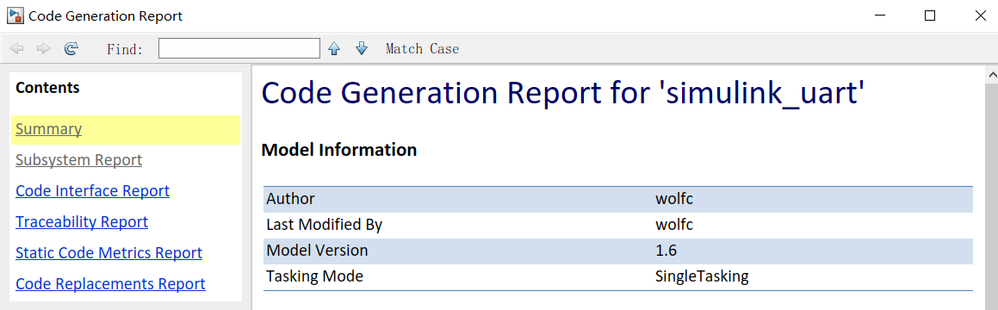

 After that I configure the parameter and build the model, and then the Simulink generate the C code.
After the help of NXP S32 ds community, the project could be compiled successfully.
But the problem is that the program doesn't run.
When I click "resume" button and start the program, it will stop somewhere in configure_flash.s file
And when I reclick the "resume" button, the program seems running, but actually not running.
I am sure the program are not running because I add some sentences to turn on the LED. However, it doesn't work.
 The console text and the project are in attachment.
Maybe my progress are not correct?
I would do appreciate it if you could help.
