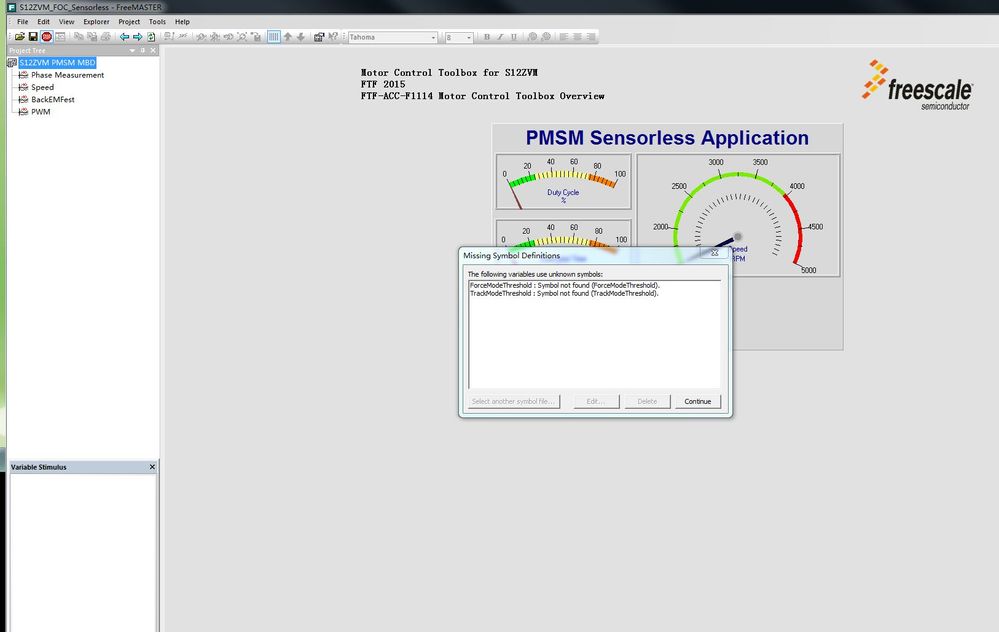

thomsonzhou
Thank you very much! Your reply is very helpful to me. My problem has been resolved.
And here is my story:
I used FreeMaster2.0 with a P&E Micro can send speed command to target board.
Everytime, when use the FOC models generate the C code automatically, there is a  pmp file inthe
target folder.
When I use freemaster2.0 open this s12zfoc.pmp project file it always show variable missing information to me.
I need to send speed command to target board with freemaster2.0.
But everytime, when I click the stop sign button, the motor does not run at all with duty cycle meter, executing time meter and tacometer changed.
Should I need to create my own freemaster command for making foc motor rotate? For your references, my freemaster2.0 command list is
empty as below picture. How to makes motor rotate with freemaster? And furthremore,
How can I make my motor retates without freemaster speed command request?
I want to make my motor rotate when the board is powered on.
Furhther more, when I use an oscilliscope to test the corresponding pins of PWM output there is no any signal output.
So, I guess, my target does not receive the speed request command at all.
Is the SCI(RX, TX) serial port is the only way to send speed command to my motor ?
Need you help.
