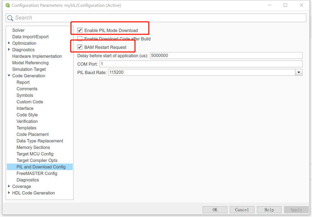

I   found the cause of the error was I ticked as follows:
But I still do not know why these makes my error in producing .elf file,and what should I do if i want to PIL the model?because if i tick them,i could not get my .elf file,then I could not dowload them through CodeWarrior,if i do not tick them,it might influences PIL?

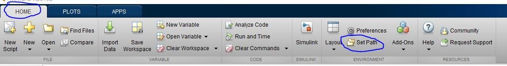

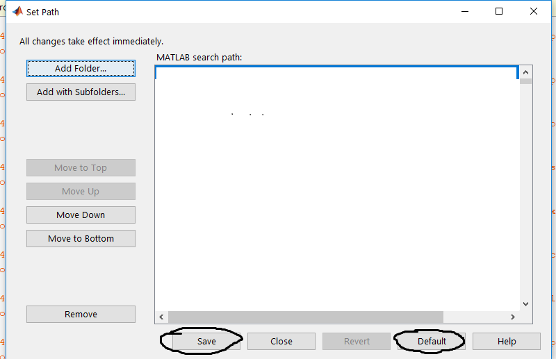

First of all, sorry for the delayed answer. It seems you're having trouble with some paths to different SIL/PIL files needed for running on this modes. Can you tell me what version of MATLAB you are using?
Also can you try and reset the MATLAB path? Sometimes we get strange issues when some paths are broken/invalid .For that you should go to MATLAB Home tab -> Set Path -> Default -> Save.
and then run the mcd_s12z_path script, so you install the path for the toolbox over a fresh, default MATLAB path.
Note: this file is located in {INSTALL_ROOT}/src.
