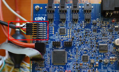

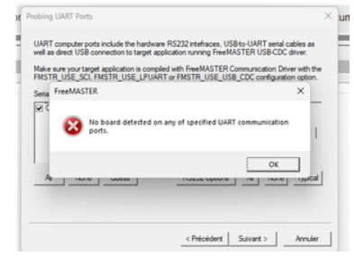

yassinechamam
on a the board Rd-k344bmu i succesfully loaded the simulink project on the board but i cannot connect the board to freemaster. I loaded the hvbmu2_772c_read_s32ct just to be sure that i didn't have a problem with config. I made sure that COM3 is the port to use.
can someone please help me ?

Hello @yassinechamam,
First of all, I want to kindly ask you to please check if you have the latest version of the MBDT for BMS installed: MBDT for BMS 1.1.0 and MBDT for S32K3xx 1.4.2. You can check this in the thread mentioned here.
1. Please check that you have the USB 2 Serial cable connected to the board in the right direction, like in the image attached, highlighted in red.

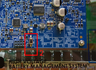

2. Please make sure that while you power the board, you keep pressing the DBG button, highlighted in the image below.
