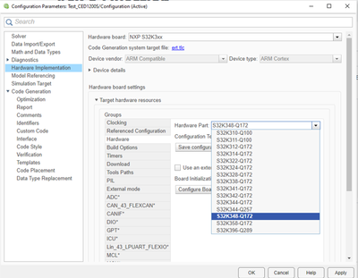

After some period successfully working on S32K3XEVB-172, we are evaluating to pass to S32K348 for a new project. The idea is to use the S32K348GHT1MJBST, that is the version in 289 BGA package.
We would like to create our own prototype and working on it with MBDT, and I'm evaluating if this device is fully supported.
Under the Hardware Implementation Tab in the project configuration, I see that only S32K348-Q172 is selectable, no BGA reference is available:
So I tried this:
- I selected the S32K348-Q172 device
- I opened the corresponding configuration template under S32 Configuration Tool (I don't have Tresos)
- In S32 Configuration Tool I modified the package in order to match the 289 BGA and saved the configuration as a new .mex file
- Then in the hardware implementation tab I used this new .mex file as Configuration Template for my project
Is this a correct approach? Or I have to consider that BGA package is not supported at all?
Or is there a different approach for BGA device?

Hello @embedded_dan73
Indeed, inside MBDT for S32K3 we offer only the option of selecting the S32K348 in the Q172 pins package. The approach you have followed is the recommended one in this use case, as the only difference between applications created for the S32K348 in the 172, and 289 pins package respectively, is represented by the configuration project associated to the model.
Since you would also like to use MBDT with a custom hardware design, that would need a pins, clocks, and peripherals configuration different than the one we provide as default inside the toolbox, creating your own .mex file and using it as a Configuration Template is the easiest way to work under such a scenario.
Please let us know if you encounter any other limitations/issues while working on this.
