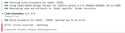

It works with all the data types I tested if I create a new model. But if I change change one of the existing models I get an unspecified error.
I tried deleting the generated mbd_rtw folder and I get the same message.
Wondering if @Maciek and @oeren5 are seeing the same thing

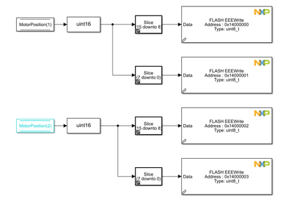

ruihang_wu
I worked around the problem for now by slicing the variable to uint8 and saving that. And concatenating the two halves when reading.
The variable was changed to int16 for unrelated reasons.
Another work around would be to follow this example
https://community.nxp.com/t5/NXP-Model-Based-Design-Tools/How-to-use-your-own-C-code-in-our-Toolbox-...
and apply the C code from this example
https://community.nxp.com/t5/S32-Design-Studio-Knowledge-Base/EXAMPLE-S32K144-EEEPROM-usage-No-SDK/t...
The matlab S function blocks will handle the read and write in this case.
I guess these are the two ways to go about it until the block is updated.

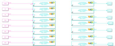

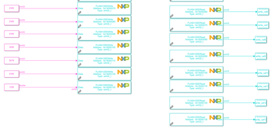

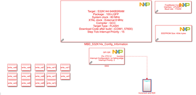

This is Ozan and I experienced similar problem with Flash EEE read and write blocks. S32K144EVB, mbdt v4.2 and Simulink 2020a is used.
I try to store 14 different data in non-volatile memory and then read the data and I could not succeed it. Normally I will use a vector with 14 elements and I use a selector to select the indented element. But for now I used 14 constant in order to test the ability. I basically write 14 constants (in type uint32) to non volatile memory with offset values 0x000, 0x0010, 0x0020...... 0x0130. Then I used Flash EEERead block to read this values and write them in to volatile memory. I used Freemaster to read the values from both volatile memory blocks (write_valx) and non-volatile address but both show different values than the ones that I used. How can I solve this problem and store multiple different data?
The screenshots of model are provided below.
Thanks in advance.
