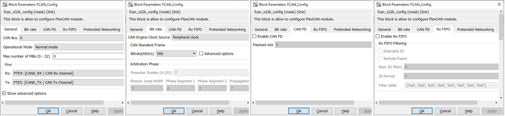

I get the following build error from the MBDT consistency check when building a model:
Error: block 'EvPowertrainController_HIL/FCAN_Config' . The configuration block should have lower priority than the ISR block (so configuration code gets generated first)! Note: right click on the block, then click on Properties to set Priority.
However, when trying to follow the suggestion, we do not see a "Priority" field in either the Config or ISR block, see below.  How can we resolve this error?
Property pages for FCAN Config block:

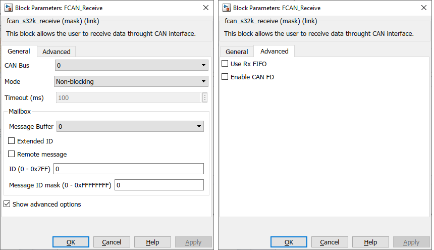

Property pages for FCAN Receive ISR block:

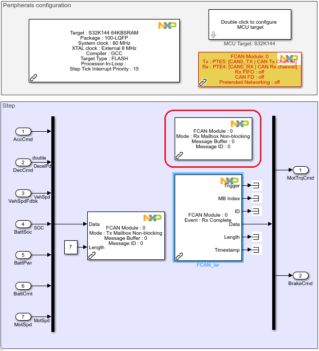

For added context, below is the contents of the model with the build error.
I tried deleting the block circled in red, suspecting it may be the source of conflict, but it did not help. Same build error.

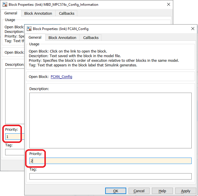

It turns out the "Priority" field was accessible by right-clicking "Properties...", instead of "Block Parameters", tried above.  The Target Config block may have been added to the model after the FCAN Config block, giving it a lower priority than the FCAN Config block, which caused the error message. Setting the Target Config block priority to 1 and the FCAN Config priority to 2 (see below) resolved the error.
