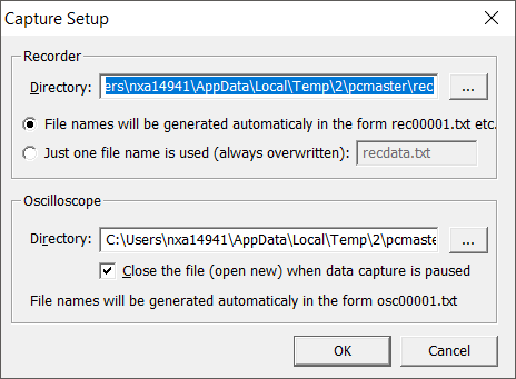

I would like to export the variables values shown in the scope/ recorder to an excel sheet/.csv file. Is there any possible method for this?

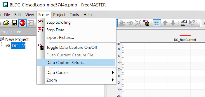

Hi [email protected]‌,
#1: Go to Scope/Data Capture Setup
#2: Configure the path where you want to save
#3: Toggle Data Capture to start/stop the data saving to file
Furthermore, there is also a scripting support for jscript/html/matlab in case you are interested. Please refer to the FreeMASTER User Manual chapter 6.
