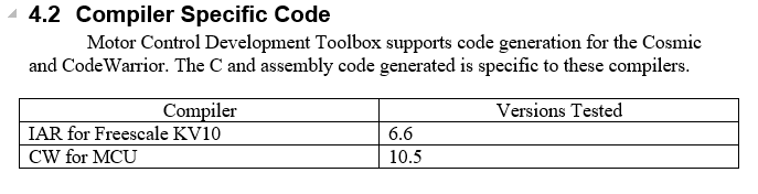

Hi, I'm working with MATLAB R2018b and the toolbox for KV3x. According to the section 2.2.7 of the "Motor Control Development Toolbox User Manual, Rev. 1.0.0, 12/2014", I must setting up the compiler for MATLAB when trying to compile a simple example, I get this error message:
-L"C:\Freescale\CW MCU v11.1\Cross_Tools\arm-none-eabi-gcc-4_7_3/lib/gcc/arm-none-eabi/4.8.0/m4/fp/v4-sp-d16" -L"C:\Freescale\CW MCU v11.1\Cross_Tools\arm-none-eabi-gcc-4_7_3/arm-none-eabi/lib/m4/fp/v4-sp-d16" -( -lm -lc -lgcc -Map kv3xf_adc.map -o kv3xf_adc.elf C:\Freescale\CW MCU v11.1\Cross_Tools\arm-none-eabi-gcc-4_7_3/bin/arm-none-eabi-ld: cannot find -lm C:\Freescale\CW MCU v11.1\Cross_Tools\arm-none-eabi-gcc-4_7_3/bin/arm-none-eabi-ld: cannot find -lc C:\Freescale\CW MCU v11.1\Cross_Tools\arm-none-eabi-gcc-4_7_3/bin/arm-none-eabi-ld: cannot find -lgcc gmake: *** [kv3xf_adc.elf] Error 1
### Build procedure for model: 'kv3xf_adc' aborted due to an error. Error make_rtw: exception id RTW:buildProcess:fatalBuildError message Error(s) encountered while building "kv3xf_adc"
Is it from the MATLAB setup or something else?
Bruno

Hello brunotremblay‌,
Can you try with a version of the compiler that is supported by the release ? [CW v10.5 for this toolbox]
This is an older toolbox and using a newer version of the compiler (v11.1 in your case) might be the problem.
Please let us know if you're still having problems with your models.
Kind regards,
Razvan.

Hello Constantin Razvan Chivu,
I've retried with the CW v10.6 (the oldest version available on the NXP site) and I get the same result.
-L"C:\Freescale\CW MCU v10.6\Cross_Tools\arm-none-eabi-gcc-4_7_3/lib/gcc/arm-none-eabi/4.8.0/m4/fp/v4-sp-d16" -L"C:\Freescale\CW MCU v10.6\Cross_Tools\arm-none-eabi-gcc-4_7_3/arm-none-eabi/lib/m4/fp/v4-sp-d16" -( -lm -lc -lgcc -Map kv3xf_adc.map -o kv3xf_adc.elf
C:\Freescale\CW MCU v10.6\Cross_Tools\arm-none-eabi-gcc-4_7_3/bin/arm-none-eabi-ld: cannot find -lm
C:\Freescale\CW MCU v10.6\Cross_Tools\arm-none-eabi-gcc-4_7_3/bin/arm-none-eabi-ld: cannot find -lc
C:\Freescale\CW MCU v10.6\Cross_Tools\arm-none-eabi-gcc-4_7_3/bin/arm-none-eabi-ld: cannot find -lgcc
As mention earlier at the 2.2.7 section, when setting the compiler for the 64-bit MATLAB with the mex -setup command, I can't select the Microsoft SDK. Instead I get :
