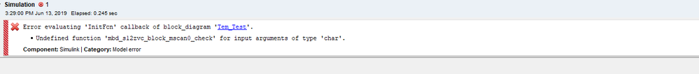

  1. I want to send more than two CAN messages, I encountered an error: MSCAN0 error Module of MSCAN0 Transmit block 'Tem_Test/CAN_Sub/CAN_Transmit' is shared with Module of another MSCAN0 Transmit block;

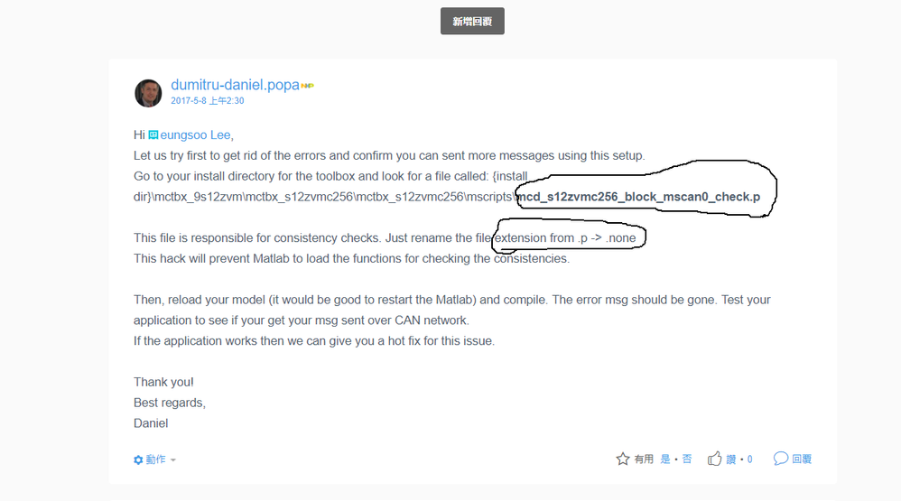

  2. so I follow the tutorial below to fix this bug, But when I modified the file ***MSCAN0_check.p→ ***.none, I encountered a new error, what should I do? Please help me, thank you.
  3. I use matlab 2015a

hi community;
The problem has been found to be a solution. as follows:
1. Follow this step to repair the .c file with the following address: "https://community.nxp.com/thread/450789";
2, mbd_s12zvc_block_mscan0_check.p file can not be directly modified to .none, you need to use the following attachment to replace;
