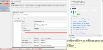

I'm trying to use PWM to control the intensity of the red LED on the S32K358, so I try to follow section 4 of this tutorial:
https://community.nxp.com/t5/NXP-Model-Based-Design-Tools/Controlling-LED-intensity-with-ADC-and-PWM...

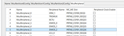

Like the tutorial 4.3, I set the Emios to enable  via Mcu -> McuModuleConfiguraion ->McuModeSettingConf - >McuPeripheral

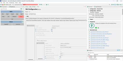

But my EmoisCommon settings are greyed out:
I'm not sure what to do now. Without the EmoisCommon config, it's giving me the error on PwmemiosBufsRef
Can anyone help me out? Thanks.

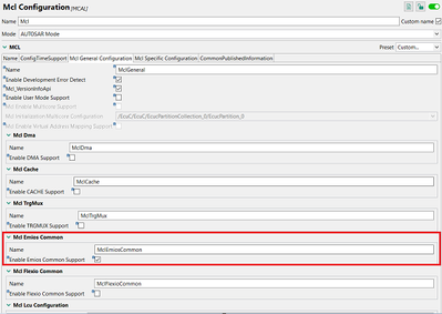

Hi @Vast-Horizon
For being able to configure Emios settings inside Mcl, you should have the following check enabled inside the Mcl General Configuration tab, as illustrated below.
Hope this helps,
Irina
