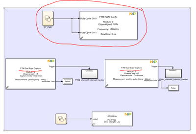

How would I go about sending out a PWM signal on 1 and then reciew a different PWM on a seperate PIN and work out the duty cycle in Simulink?

We might have the right example for you in our toolbox, which does exactly what you want, generating the PWM example on PWM 0 and reading the characteristics on other pins, using the Dual Edge Capture blocks for MBDT for S32K1xx. The example is called ftm_dual_edge_s32k14x and it is delivered in our toolbox.
Please let us know if this is what you are looking for!

So I have managed to set this up on the S32K144EVB but I am only able to read either duty cycle or frequency at the moment. How do I go about measuring frequency at the same time as the frequency changes and therefore the duty cycle needs to be scaled depending on the frequency. I will attach the modified version of the able example you mentioned. This output the duty cycle but I have fixed the 10Hz frequency as it is known:
Also, how do I detect frequencies 0-10Hz? It seems from the UINT16 calcs that the lowest frequency that can be read is 9.54Hz? Frequency = 1/(65535/625000).
Here is the range I need to detect and calculate duty cycle in:
Thanks!
