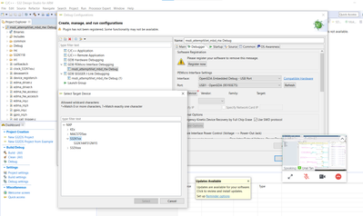

Hi @marius
my model is design on S32k118
i have following the tutorial to import the generated code to S32 DS version 1.3
Can compile the code on S32 DS, but there is no option to change to S32k118 target in the debug configuration ==> i am not able to debug the generated code on S32k118 development kit.
my generated code is attached.

joshua_hong
Hi @viet , @mariuslucianand ,
turns out that the <LinkerOptList> <Option> has paths that has space characters.
if we remove the space characters in <LinkerOptList> <Option>, and import the ProjectInfo.xml into S32DS for ARM 2.2, the project will be imported with C/C++ Build option available.
Best Regard
Joshua
Field Application Engineer
WT Microelectronics

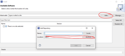

mariuslucianand
Hello @viet
Please download the archive from the following link:
Once you have the archive, please go to S32DS for ARM 2.2. Go to Help, select Install new Software, press Add and browse for the archive and follow the instructions.
That should be all.
The only thing to do is to please check to don't have some blank spaces in the path, like  "MATLAB AddOns".
Hope this helps,
