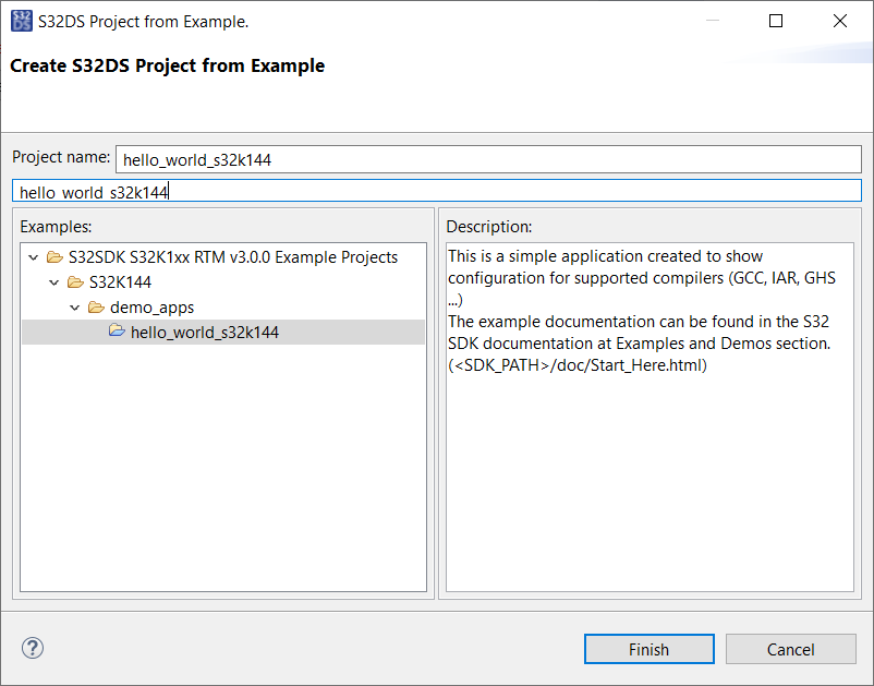

1. Create a project from hello_world_s32k144 S32DS example  from File -> S32DS project from Example menu.
2. Open Run -> Debug Configurations ..., select hello_world_s32k144_debug_flash_pemicro configuration. For the C/C++ Application input select MBD_S32K_ROOT\tools\BootLoader\RBF_Files\S32K144_S32DS_UART1_CAN0.rbf tfile o flash, where MBD_S32K_ROOT is the output of mbd_find_s32k_root command in Matlab.
3. Press Debug button to write the RappiD bootloader to the board and once the debugger finishes to write the file to the board press the Disconnect button from toolbar or from Run -> Disconnect menu.

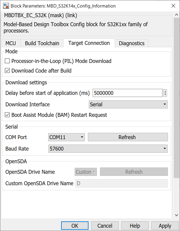

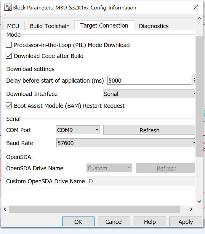

After you write the bootloader to the board, you have to change the Target Configuration parameters form the MBD_S32K14x_Config_Information:
1. Select Download Code after Build option.
2. Select Serial option for the Download Interface to downloand the appliction using the RappiD bootloader.
3. Select Boot Assist Module (BAM) Restart Request option.
3. Connect the S32K board to the PC and press the Refresh button to update the list of available COM Ports.
4. Select the COM Port of the S32K board.
5. Press the OK button to save the changes.

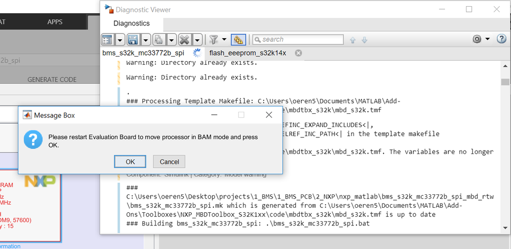

Now you can build the model as you would had done for OpenSDA. At the end of the build, you will see a dialog that will request you to reset the board. To do this you have to press the Reset button (SW5) on the S32K144-Q100 EVB board, next to the USB port, and click OK button in the dialog to start the download operation.
Once you reset the board, the application will be downloaded to the board and it should start to run.

I followed your steps and firstly download the rbf file by using debug tool of S32DS for Arm. Then I configured the MBD_S32K14x_Config_Information as follow:
Then I successfully download the code and received the restart window and I pressed the start button and observe the RAppID progress:

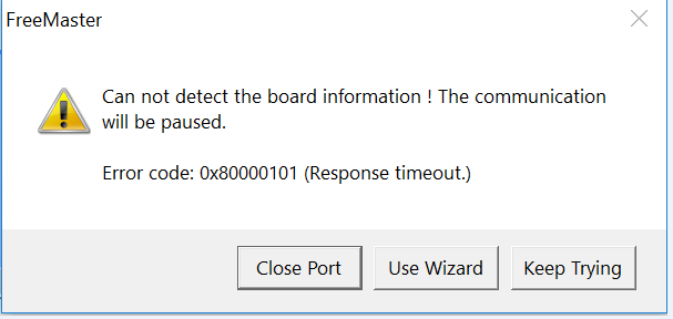

After that the code is downloaded and I observe the data by using Freemaster tool. But when I powered off the board and turned on again in order to test the non-volatile memory I constantly received communication error in Freemaster and could not test the data. I received following error code and I wonder whether it is related with Freemaster or something I do. How can I fix this problem and observe that the data stored permanently even though the board is turned off and turned back on?
Thanks in advance.
