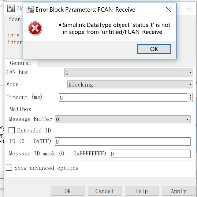

1.) Is anyone using the Toolbox for MPC57xx Version 3.0? If so,
2.) Have you used FCAN_Receive with Blocking Mode? If so,
3.) Can you share your model with JUST FCAN_Receive blocks with Blocking Mode? I only want to see if there is someone who actually can use it.

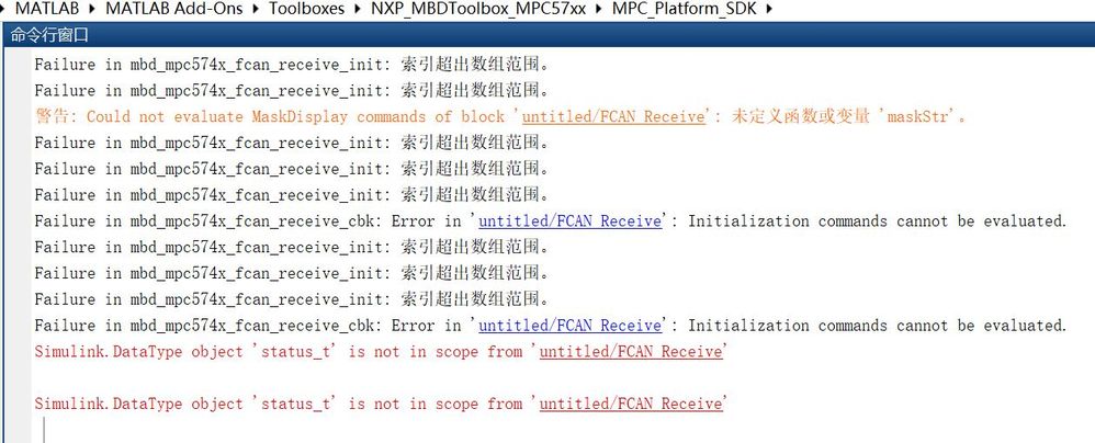

Finally new version 3.2 fixed the error for CAN receive blocking mode. But it only did half of the job. The help description doesn't match the actual block set. And there is no example. I don't even know how to make it working. Come on, NXP engineers! you guys can do better job than this!

Hi [email protected]‌,
You can find examples for FCAN Send/Receive Blocking mode in the <MBDT_ROOT>/MPC_Examples/mpc574x/fcan folder:
  • flexcan_echo_blocking_mpc574x, for MPC5744P.
  • flexcan_echo_blocking_mpc574xg.mdl, for MPC5748G.
  • flexcan_echo_blocking_mpc574xr.mdl, for MPC5746R.
and in <MBDT_ROOT>/MPC_Examples/mpc577x/fcan folder:
  • flexcan_echo_mpc5777c.mdl, for MPC5777C.
The <MBDT_ROOT> is the folder where the toolbox is installed. To find it, you can run mbd_find_mpc_root() command in Matlab console or navigate to it from the Add-On Manager window.
The outputs of the blocking FCAN_Receive block are:
  • Status (enum)
  • ID (uint8)
  • Data (uint8(8))
  • Length (uint8)
  • Timestamp (uint16)
The Status and ID output labels from the FCAN_Receive block are hidden under the NXP logo. Resize the block and make it bigger to see all output labels.
The output of the blocking FCAN_Send is:
  • Status (enum)
Status enum output is a Simulink enumeration mapped to the status_t C enum from SDK. Supported values for FCAN are:
  • status_t.STATUS_SUCCESS if successful
  • status_t.STATUS_TIMEOUT if the timeout is reached
  • status_t.STATUS_BUSY if another receive/send using the same message buffer is in progress
To see the values of the status_t enumeration, type in Matlab console status_t. and press the TAB key.
Check the example models to see how to use the status output.
Thank you for reporting this issue. I will update the help page in a future release or cumulative patch.
Paul
