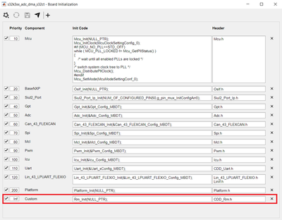

Inside the model, by accessing the Configuration Parameters, the Rm component must be added in the initialization sequence, for DMAMUX initialization, by pressing the Configure Board Initialization button, which can be found under the following settings:
Inside this list, enabling the initialization of the default components MBDT provides support for, custom initialization sequences could be added by pressing the '+' button and inserting the specific code.

Hi again, @Irina_Costachescu .
I'm sorry to annoying you with my questions, but I'm still facing some issues.
I tried your example, I made two different tests:
1) first test: I took your model, exactly as you attached here in your previous reply, but it doesn't generate code, I receive an error regarding the typedef data Adc_ValueGroupType, here is an extract of the compiling log:
ID:/A_Lavoro/Matlab/NXP/Test_DMA/s32k3xx_adc_dma_s32ct_Config/Project_Settings/Debugger -ID:/A_Lavoro/Matlab/NXP/Test_DMA/s32k3xx_adc_dma_s32ct_Config/Project_Settings/Linker_Files -ID:/A_Lavoro/Matlab/NXP/Test_DMA/s32k3xx_adc_dma_s32ct_Config/Project_Settings/StIn file included from D:/A_Lavoro/Matlab/NXP/Test_DMA/s32k3xx_adc_dma_s32ct_ert_rtw/s32k3xx_adc_dma_s32ct.c:17: D:/A_Lavoro/Matlab/NXP/Test_DMA/s32k3xx_adc_dma_s32ct_ert_rtw/s32k3xx_adc_dma_s32ct_private.h:22:8: error: unknown type name 'Adc_ValueGroupType' 22 | extern Adc_ValueGroupType* Adc1Group_0_ResultBufferPtr;
I'm not able to understand what is generating the issue, because I checked all the inlcude files but it seems that the Adc_ValueGroupType data, defined in Adc_Ipw_Types.h, is correctly included in the header files.
2) second test: as I was not able to try directly your example, I recreated it on my test model, adding all the required setup as from your mex file and your clear tutorial. My model compiles and generate code, but I can't see anything coming from ADC reading. A difference between your and my model: I don't use FreeMASTER but, instead, as I'm using CAN Bus for other functionalities, I put the data I want to monitor on a CAN Bus message. What I see is that the Adc1Group0Notification, that should return the ADC channel read with DMA, is never asserted (I put a code spy toggle in this handler as an additional  monitor, and I never see the port toggling).
So I would please ask if you can check for any mistake by my side...
I attach to this post the two projects:
Test_DMA_Original_NotCompiling.zip is the project I created with your example (this project doesn't generate code and gives the error about the Adc_ValueGroupType)
Test_S32K344_DMA.zip is the project I made following your tutorial (this project generates code but the ADC reading callback seems never to be asserted).

Irina_Costachescu
Hi @embedded_dan73 ,
The issue you are facing is related to a difference between MATLAB versions in terms of the order in which some header files are included inside the model generated code. I have developed and tested the model sent in the previous thread in R2021a to ensure compatibility with any newer MATLAB releases you might be using. When testing in 2022b I have encountered the same problem, for which I am proposing the following fix - the attached adc.tlc file addresses the Adc header files includes in a manner which is not impacted by the order in which header files are included in the generated code.
Could you please extract the adc.tlc file and copy it inside <toolbox_root>/mbdtbx_s32k3/+mbd_s32k3/+common/blocks/adc folder?
After this step, could you please try and test the original model that I have sent (Test_DMA_Original_NotCompiling) to firstly ensure that ADC and DMA functionality, decoupled from the rest of your application, compiles successfully and works as expected? Before doing this, I would also recommend you to remove any artifacts of the previous build (i.e cleanup the cache and codegen folders of your project).
Now, for the second model (Test_S32K344_DMA), this issue was not reproducible because in here multiple MBDT blocks are used, adding various headers in the generated code, which included also the file missing in case no. 1. However, in the configuration you have attached, please note that the Rm component needs to be configured using the PRE-COMPILE variant to match the Rm_Init(NULL_PTR) call inside the Board Initialization. If configured in PRE-COMPILE mode, the drivers will use an internal structure containing the selected settings for initialization, hence the NULL_PTR argument. However, if the configuration variant is set to POST-BUILD, the Rm_Init function won't use the internally defined structure, and it will expect a parameter to be passed (e.g Rm_Config_MBDT - structure defined in the .mex file generated code). You can also see that, inside the Board Initialization list, there are some components which are using this kind of initialization (e.g Adc_Init(&Adc_Config_MBDT);), meaning that they are configured in POST-BUILD mode.
For this, I have also attached a .mex configuration file, which you could copy next to your model, containing this update (Rm component configured as PRE-COMPILE).
Moreover, since the Test_S32K344_DMA application you have shared also contains the PWM-BCTU-ADC hardware trigger implementation, I have added inside this .mex file the setting mentioned in the other thread as well (ADC hardware trigger behavior on S32K344). With this configuration, I have tested your model to ensure that both solutions are working together - ADC conversion and DMA data transfer on ADC1 + PWM hardware triggering conversions on two different channels of ADC2.
1. Using a logic analyzer I have validated that the signals SPY1 and SPY2 are toggling at corresponding PWM triggers rising edges.
2. Using FreeMASTER I have checked the evolution of the ADC_POT0 variable when manipulating the on-board potentiometer.
Please let me know if this is the use case that you are trying to achieve or if there are additional details that should be covered and taken into consideration for developing your application.

embedded_dan73
Hi @Irina_Costachescu ,
first of all sorry if I was very late in my answer, but I was out of office for some days and had other issues that delayed me in this activity.
I was finally able this morning to read and test your solution and works perfectly, I understand the mistake I made about the build option of RM module, and also it's clear the behavior of ADC triggering via BCTU that you explained in the other question I posted (ADC hardware trigger behavior on S32K344) and also applied here: it wasn't clear to me that the trigger time is not joined with phase shift of the PWM, and in fact I wasn't able to give a clear behavior of the spy codes I saw in my original model. Now with your help it's all clear.
I would thank you once again for your detailed explanation and support, I think I have now all the informations and clarifications I need for developing my application.
