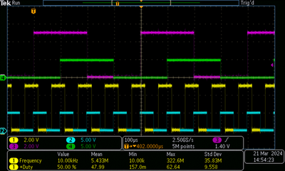

What I see, instead, is that the trigger occurs every two PWM cycles, as if for any period only one trigger was asserted. But actually, as you can see in following picture, I set the PWM outputs in order to have a phase shift between them, in order to be sure not the triggers to be asserted at the same time (I know that, if it would happen, only the trigger with major priority is served):
Yellow waveform: PWM #1
Green waveform: Trigger #1 spycode (toggle on ADC conversion complete isr callback)
Light blue waveform: PWM #2
Purple waveform: Trigger #2 spycode (toggle on ADC conversion complete isr callback)

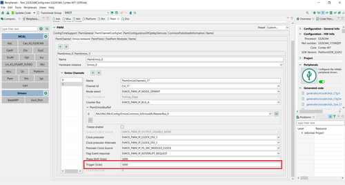

Now, for the behavior that you would like to achieve, you could shift the Trigger signal that the PWM channel is sending to BCTU, so that they are not asserted in the same time. You could do that using the Trigger option in the S32 Configuration Tool - I have set it to 5000 ticks to match the signal displayed on the oscilloscope.

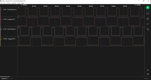

With these setting in place, when running the model on target, I am obtaining the following behavior:
At each PWM signal rising edge, its corresponding trigger is asserted, action which starts the ADC conversion on the specific channel and toggles the corresponding SPY signal used inside the ADC group notification.
  • PwmChannel_0 (PTA1) sends a trigger to BCTU at its rising edge which subsequently triggers Group0. Inside Group0 notification PTA12 (SPY1 signal) is toggled.
  • PwmChannel_1 (PTA0) sends a trigger to BCTU at its rising edge which subsequently triggers Group1. Inside Group1 notification PTB12 (SPY2 signal) is toggled.

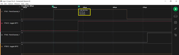

The time difference between the PWM rising edge and the SPY signal toggle is caused by the overhead introduced by the functions executed between the moment when the trigger was asserted and the time when the Dio_WriteChannel function was called.
To minimize this time and obtain more accurate results, I would recommend you to perform the SPY signal toggling as the first action inside the ADC groups notification. For this, you could set the Dio block Priority to 1, and increase it for the others, keeping the order in which they should be executed. Please note that this will not remove this delta time completely, since other functions are also performed inside the drivers between these two actions (the callback is called from inside the ISR function associated to the interrupt, and several operations are performed before executing this callback as well).
