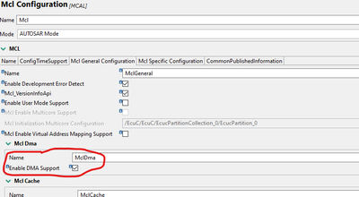

1) Enabled DMA Support in McI Configuration:

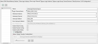

2) Added DMA Logic Instance and DMA Logic Channel in McI Specific Configuration tab:

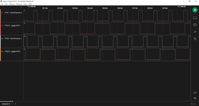

Moreover, since the Test_S32K344_DMA application you have shared also contains the PWM-BCTU-ADC hardware trigger implementation, I have added inside this .mex file the setting mentioned in the other thread as well (ADC hardware trigger behavior on S32K344). With this configuration, I have tested your model to ensure that both solutions are working together - ADC conversion and DMA data transfer on ADC1 + PWM hardware triggering conversions on two different channels of ADC2.

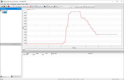

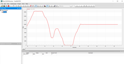

1. Using a logic analyzer I have validated that the signals SPY1 and SPY2 are toggling at corresponding PWM triggers rising edges.
2. Using FreeMASTER I have checked the evolution of the ADC_POT0 variable when manipulating the on-board potentiometer.
Please let me know if this is the use case that you are trying to achieve or if there are additional details that should be covered and taken into consideration for developing your application.

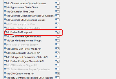

  • ADC1 interrupts were disabled from the AdcInterrupt tab of the Adc component configuration and the DMA support was enabled in the AutosarExt tab.
  • AdcHwUnit_1 uses the Adc_Dma_Channel for transfering the data, and this channel is configured inside the Mcl component.
2. DMA Configuration
2.1 Mcl
  • Dma_Adc_Channel was configured to use the DMA hardware channel 0
  • The Interrupt Callback, executed when the DMA transfer is completed, is configured for Adc_Ipw_Adc1DmaTransferCompleteNotification - this callback is already defined and implemented by the drivers MBDT generates code on top of, and it will be executed from the DMA peripheral interrupt service routine, as detailed below.

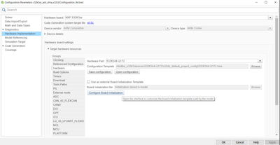

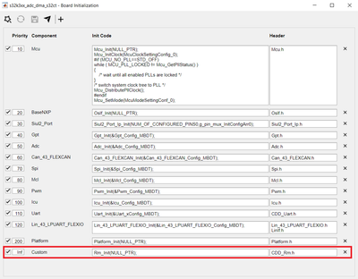

Inside the model, by accessing the Configuration Parameters, the Rm component must be added in the initialization sequence, for DMAMUX initialization, by pressing the Configure Board Initialization button, which can be found under the following settings:
Inside this list, enabling the initialization of the default components MBDT provides support for, custom initialization sequences could be added by pressing the '+' button and inserting the specific code.

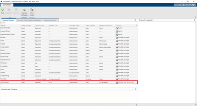

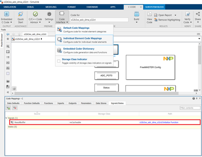

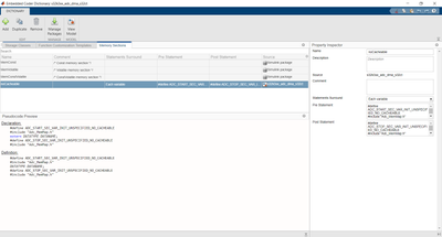

One additional setting that must be performed inside the model is to declare the ResultBuffer (where the DMA will transfer data) in a non cacheable memory section. When a DMA transfer changes the contents of main memory that has been cached by the processor, the data stored in the cache will have the previous (not updated) value, which might provide inconclusive results while reading the conversion results in this way.
This was implemented by associating to the ResultBuffer signal (which will be used as a variable in the generated code, its address being passed to the Adc_SetupResultBuffer function) a custom defined Storage Class, which places the buffer in a non cacheable memory section. This can be set by accessing the following Simulink model menus: Apps - Embedded Coder - Code Interface - Individual Element Code Mappings.
The noCacheable Storage Class has associated a custom Memory Section, implementing this variable placement in a non cacheable memory section with the help of the drivers Adc_MemMap.h file - contains keywords which control the assignment of variables and functions to specific sections.
For more details on this Simulink functionality, I am attaching the following reference https://www.mathworks.com/help/ecoder/ug/design-custom-storage-classes-and-memory-sections.html.
A FreeMaster project delivered as well together with the model and the configuration allows the real time visualization of the ADC_POT0 variable based on the potentiometer position.
Hope this helps. Please let me know in case there are any issues in testing this model on your side.

The issue you are facing is related to a difference between MATLAB versions in terms of the order in which some header files are included inside the model generated code. I have developed and tested the model sent in the previous thread in R2021a to ensure compatibility with any newer MATLAB releases you might be using. When testing in 2022b I have encountered the same problem, for which I am proposing the following fix - the attached adc.tlc file addresses the Adc header files includes in a manner which is not impacted by the order in which header files are included in the generated code.
Could you please extract the adc.tlc file and copy it inside <toolbox_root>/mbdtbx_s32k3/+mbd_s32k3/+common/blocks/adc folder?
After this step, could you please try and test the original model that I have sent (Test_DMA_Original_NotCompiling) to firstly ensure that ADC and DMA functionality, decoupled from the rest of your application, compiles successfully and works as expected? Before doing this, I would also recommend you to remove any artifacts of the previous build (i.e cleanup the cache and codegen folders of your project).
Now, for the second model (Test_S32K344_DMA), this issue was not reproducible because in here multiple MBDT blocks are used, adding various headers in the generated code, which included also the file missing in case no. 1. However, in the configuration you have attached, please note that the Rm component needs to be configured using the PRE-COMPILE variant to match the Rm_Init(NULL_PTR) call inside the Board Initialization. If configured in PRE-COMPILE mode, the drivers will use an internal structure containing the selected settings for initialization, hence the NULL_PTR argument. However, if the configuration variant is set to POST-BUILD, the Rm_Init function won't use the internally defined structure, and it will expect a parameter to be passed (e.g Rm_Config_MBDT - structure defined in the .mex file generated code). You can also see that, inside the Board Initialization list, there are some components which are using this kind of initialization (e.g Adc_Init(&Adc_Config_MBDT);), meaning that they are configured in POST-BUILD mode.
For this, I have also attached a .mex configuration file, which you could copy next to your model, containing this update (Rm component configured as PRE-COMPILE).

I was finally able this morning to read and test your solution and works perfectly, I understand the mistake I made about the build option of RM module, and also it's clear the behavior of ADC triggering via BCTU that you explained in the other question I posted (ADC hardware trigger behavior on S32K344) and also applied here: it wasn't clear to me that the trigger time is not joined with phase shift of the PWM, and in fact I wasn't able to give a clear behavior of the spy codes I saw in my original model. Now with your help it's all clear.
I would thank you once again for your detailed explanation and support, I think I have now all the informations and clarifications I need for developing my application.
