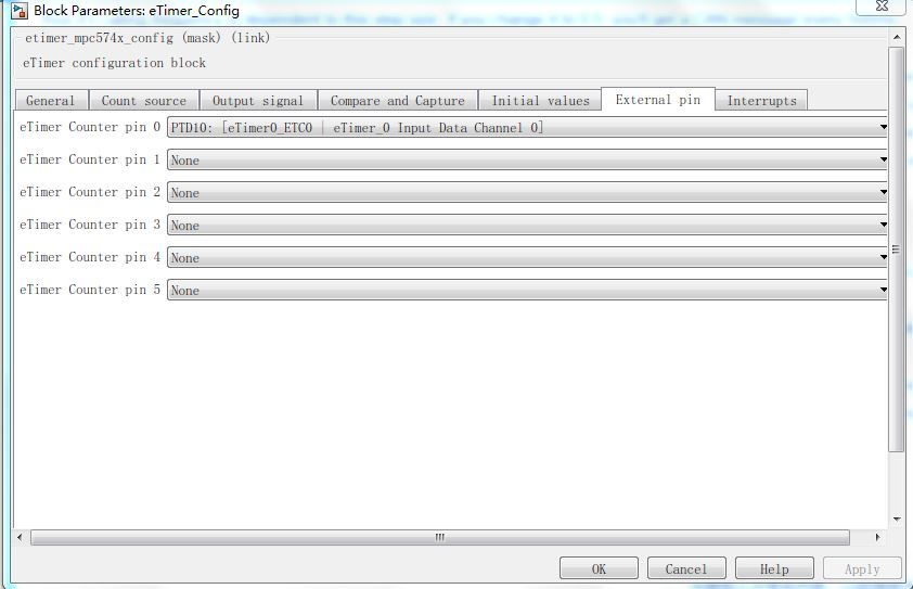

Hello:
   For the timer demo of MPC5744P MBD Toolbox: 'etimer_input_frequency_mpc574xP'.
   It works well if I do nothing modification.

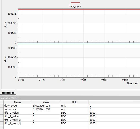

   Then I only change the counter 0 input pin from PTA0 to PTD10 in the "eTimer_Config" block. It doesn't work.
   It's the same for the counter 1 and conter 2, the first pin option is OK and the second pin option is not OK.

Hello yanshimian‌,
Have you applied the patch from this thread https://community.nxp.com/thread/499879 ?
Marius
2,114 Views
yanshimian
Thanks for your help, it's OK now.
