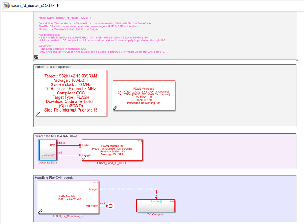

Hello all,
I am using the S32K142 Demoboard with the Model Based Design Toolbox.
Everything works well, but try to change the period of the TX CAN message in the example flexcan_fd_master_s32K14x.

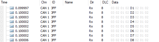

The model sends the message every 100ms
Where can I change the time for example to 500ms?
Thanks for a hint.
Erik

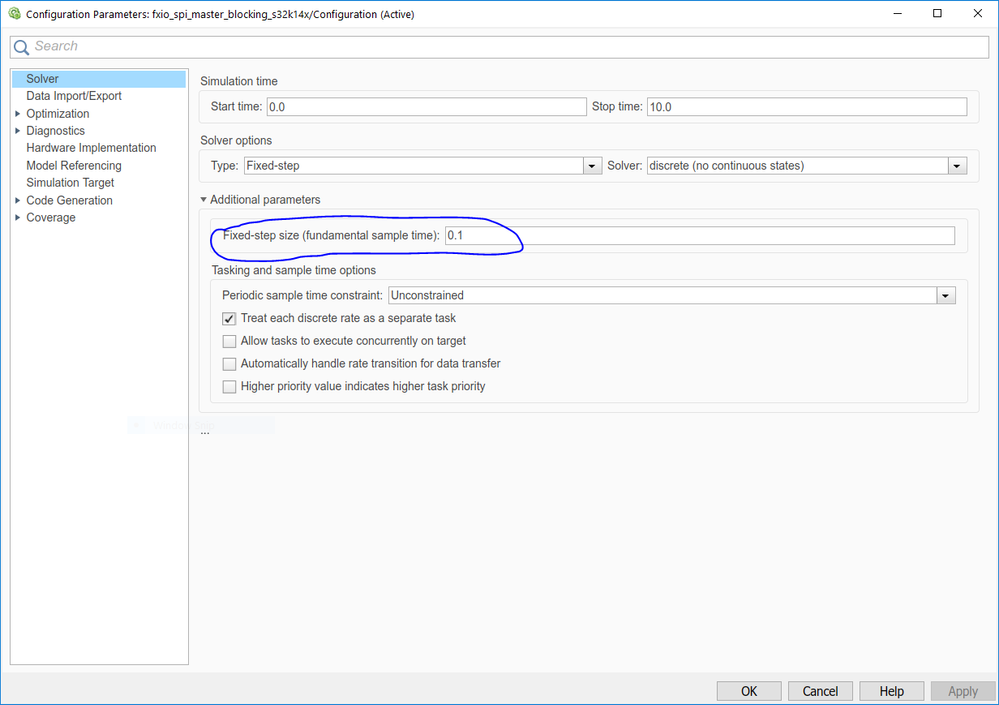

The code in the main loop is triggered by a low power timer, and the period of this timer is controlled by the discrete fixed step. You can change this from Model Configuration Parameters -> Solver -> Fixed step-size.
So an easy way to change the period of the CAN messages is to change this value, as CAN Send block is in the main loop, thus it's calling frequency is dependent to this step size. If you change it to 0.5, you'll get a CAN message every 500ms.
