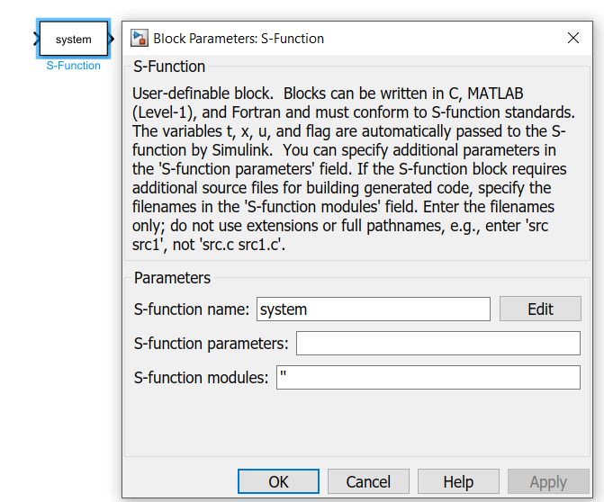

STEP3: Add a standard S-function Simulink block into your customMBDT.mdl file
Now comes the tricky parts: you need to create your own User Interface and Custom Code when this S-function block is used in a model.
STEP4: Create or associate a S-Function Level 2 file with your block. This will tell Simulink what are the inputs/outputs and other various parameters of your block.

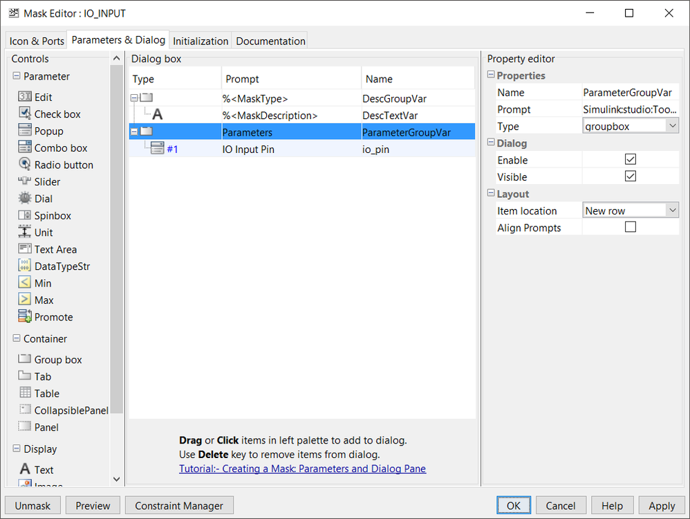

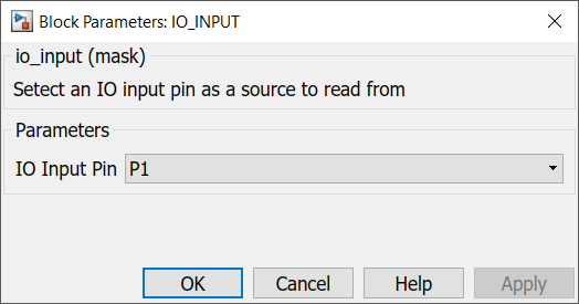

STEP7: build your own User Interface to allow custom code customization. Use right click on the block and select Edit Mask to implement your own user interface.
This will show something like this:
STEP8. Save the block into the Simulink custom library model you have created at step 1 and you should have your own block that allows you to call your custom code into the Simulink environment.
