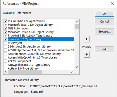

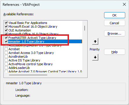

Hello Ahmed,
the script below works in my test Excel file. Make sure you have the objects referenced in VBA. Go to Tools/References menu and check both FreeMASTER and also mmaster object (you may need to browse for mmaster.dll in the FreeMASTER installation).

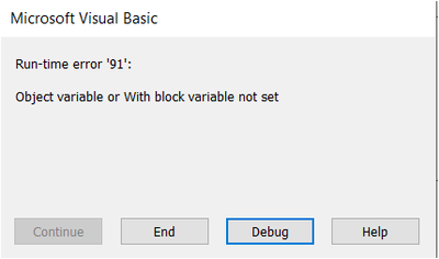

12,917 Views
Ahmed_Abd_El-Hafez
Hello Michal,
Thank you for your help. It opens two new FreeMaster files momentarily and then gives this error.
on this line:
I replaced "A" & "B" by the names of my files written like "SpdControl.pmp" and tried also to write the total pathes of files since I want to open these two files not to open two new instances. I had the objects referenced in VBA.
12,912 Views
MichalH
NXP Apps Support
NXP Apps Support
Can you try exactly my code? Just to compare the behaviors. Note that there may be difference in 32bit and 64bit version of Excel. I'm testing 64bit version.
You can also put breakpoint to examine a and b variables if they are indeed set to "Nothing".
Just to be fully sure the installation is correct, please run "register.bat" as administrator in the FreeMASTER installation folder (c:\NXP\FreeMASTER 3.2\FreeMASTER\register.bat)
Michal
12,894 Views
Ahmed_Abd_El-Hafez
Same error in the same line when I used exactly your code without any change.
Yes a & b are set to nothing.
When I run register.bat it gives black window momentarily and then disappears. I don't know what this means.
The Excel I use is 32 bit. It seems that this causes the difference.

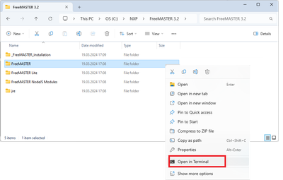

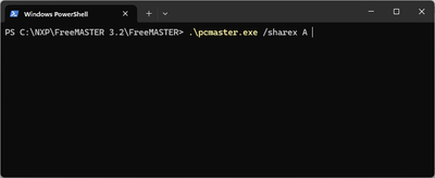

The /sharex is a command-line option which you can use as a parameter when running the FreeMASTER process (pcmaster.exe). You need to run it manually from command line prompt, or you can create a launcher icon with the parameter.
Steps to run it manually.
  1. Open Windows Explorer and browse to "c:\NXP\FreeMASTER 3.2"
  2. Right click the FreeMASTER folder and select "Open in Terminal"
  3. Type .\pcmaster.exe /sharex NAME
  4. The NAME is your name which later use in the GetAppObject() call
Michal

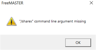

Ahmed_Abd_El-Hafez
When I write this command as shown, it opens a new FreeMaster project for moments and close it away. It doesn't open the already created project "SpdControl.pmp" why?
12,598 Views
MichalH
NXP Apps Support
NXP Apps Support
Hello Ahmed,
the first parameter after /sharex option is NOT the name of the pmp project file, it is a name under which the running instance will be identified for mult.GetAppObject. If you want to open a project too, you need to specify it after the name.
Examples:
pcmaster.exe C:\path\SpdControl.pmp    // will just open the project file
pcmaster.exe /sharex SPD       // will run the FreeMASTER named SPD,
// so you can attach to it using GetAppObject("SPD")
pcmaster.exe /sharex SPD C:\path\SpdControl.pmp // will do both
So, in all your examples you passed just one argument after /sharex option, which means it should have started the FreeMASTER without opening any project. You say that the application closes immediately after started... this may be an indication of a problem with installation.

Ahmed_Abd_El-Hafez
It just runs the two instances and cannot access them and gives the error in the figure below.
The examples you mentioned tries to access one FreeMaster only not two. Accessing one FreeMaster had worked with me before.

MichalH
NXP Apps Support
NXP Apps Support

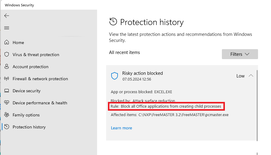

Hmm, this seems the "mult" object living in Excel VBA has a problem to launch FreeMASTER with correct instance name as argument. I think you have a problem in the way you pass the instance name ("A" or "B") when you call "GetAppObject". You can upload the Excel file as an attachment so I could take a look at the script.
Anyway, if you run the instances manually from command-line with the name "A" (pcmaster.exe /sharex A) or with the name "B" (pcmaster.exe /sharex B). Then the Excel VBA should be able to locate it.
Michal
