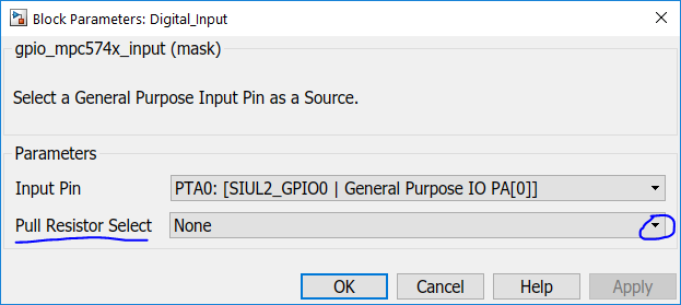

In the GPI Read block, you can find Pull Resistor Select from the mask:
Kind regards,
Razvan.

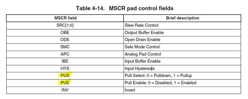

How can I configure the GPO for weak pull up and pull down (as shown in the picture below with PUS and PUE)?
Please help on on that.
Kind Regards
Abhishek

From the Pull resistor select you can select the following:
None - PUE 0, PUS 0
Pulldown - PUE 1, PUS 0
Pullup - PUE 1, PUS 1
If you select None this will do the following: PUE: 0 (disabled); PUS: 0 (no effect since PUE is disabled).
If you select Pulldown this will do the following: PUE: 1 (enabled); PUS: 0 (pulldown enabled)
If you select Pullup this will do the following: PUE: 1 (enabled); PUS: 1 (pullup enabled).

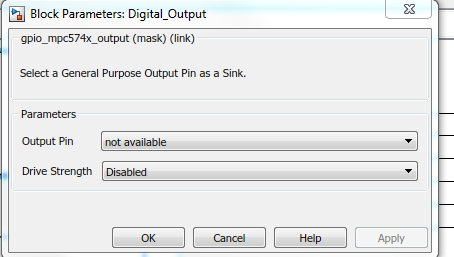

The question is in regard to GPO. Can we change it for GPO.
Abhishek

Sorry, did not notice you mentioned GPO in your last reply. For this you can not select anything. It is PORT_INTERNAL_PULL_NOT_ENABLED by default when output is used. If you want to be able to change it, we can use custom code blocks to add a call to an SDK function (PINS_SetPullSel) where you can set it to what you want. Let us know if this is what you want/need and we'll help you with this.

For the GPO's, we would like to change PUS and PUE bit. It would be great if a block for that can be created or you can guide us on how to do that for Model Based Design.

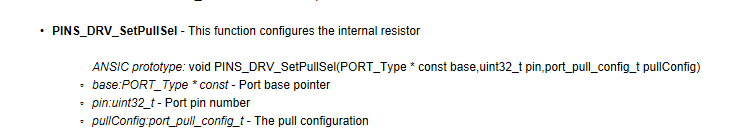

2. In S32 Design Studio Documentation, I can not find parameter explaination for the PinSettings Function -> PinSettings documentation -
    • PINS_DRV_SetPullSel(PORT_Type * const base,uint32_t pin,port_pull_config_t pullConfig)
(see below snapshot), I mean, I do not know what are the values of Port_Type for Pin PTC12 (as in the attached model)

Where can I find S32K SDK Manual, with precisely the information you gave me.
Where can i find the Function description with parameter values as I found the function but not the parameter values
7,444 Views

For information on how the function is implemented, you can find PINS_SetPullSel (as this is the function called by  PINS_DRV_SetPullSel) in the siul2_hw_access.h file:
