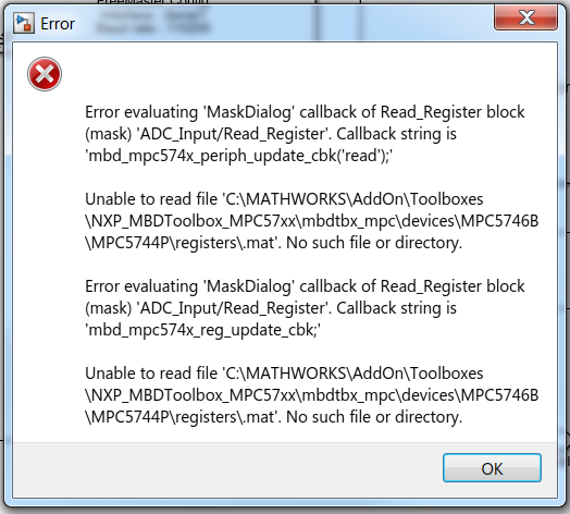

I am using the MPC5744P toolbox on Matlab and I got the following error when I tried to load the Read_Register/Write_Register:
What could I do?
Regards, Rafael

Hello [email protected]‌,
When I opened your model, everything seems to be fine.
I was able to open every block (ADC config, start, main config, freemaster) without any issues - so it must be a problem with some paths. A simple way to check if this is indeed what is causing those errors, you could go to Set Path -> Default -> Save
and then run the mbd_mpc_path script (from the toolbox installation root).
Note that after resetting the MATLAB path to default, you'll lose paths to other toolboxes you might have had, so you'll have to add them later.
Let us know if you're still having problems.
Kind regards,
Razvan.

ext-rafael_barb
Dear Razvan,
The issue appear when trying to load the Write_Register or Read_Register block on the model.
The model without these block, indeed are ok.
Please consider the new model that I am sending, which I can face the error just double clicking either the Read_Register or Write_Register block.
Kind Regards, Rafael

constantinrazva
Even with the new model you provided, I was still able to open all blocks without facing any issues. This makes me think this is due to some paths being broken - so I would still suggest you clean the MATLAB path, run the script mentioned above and see if everything works now.
Kind regards,
Razvan.
4,406 Views
ext-rafael_barb
Dear Razvan,
After run mbd_mpc_path it works.
Thank you for the Suport!
