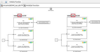

Adrian_Gherca
Please make sure that the transceiver corresponding to CAN1 is properly activated. This is done in the Initialize Function of the Simulink model:
An example that uses CAN0 and CAN1 instances of the FLEXCAN peripheral can be found in the MBDT_S32K3xx toolbox: src\S32K3_Examples\MR-CANHUBK344\mrcanhubk344_can_ebt .
For more info please have a look this article: Communicating over the CAN Bus

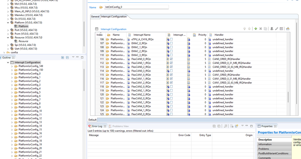

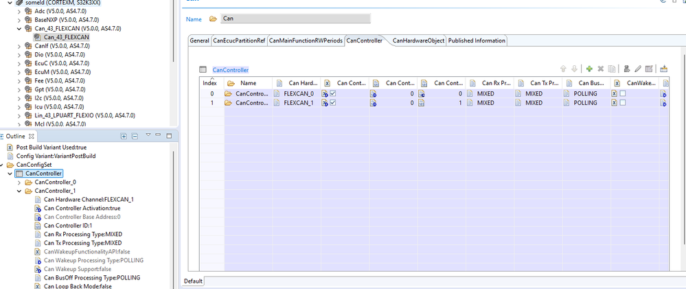

MaMM
Hello Adrian.
Thanks for the answer. The problem I'm having is that the processor doesn't start. I'm using the S32K396-BGA-DC1 Evaluation Board, and the CAN0 is working fine. However, when I configure CAN1, the processor doesn't start. (I have an LED with a flip-flop to ensure the SW is up and running). I have activated CAN1 in the configuration, through an interrupt, and enabled the FLEXCAN1 interrupts. Looking at the example you mentioned, I don't see any differences between my configuration and the example, but I may be missing something. I have also included the CAN_Set_Control_Mode block in Simulink, with the CAN_CS_STARTED function, pointing to CAN1...CAN config capture 1.pngCAN config capture 1.pngCAN config capture 2.pngCAN config capture 2.pngCAN config capture 3.pngCAN config capture 3.pngCAN config capture 4.pngCAN config capture 4.png
Any idea?
