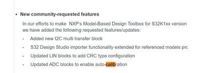

p_a_u_darshana
How can I enable ADC calibration in Simulink?
V4.2.0 product release report says that it is available in the block. But I cannot find any option in the ADC config block.

Hello @p_a_u_darshana ,
The AutoCalibration function is called automatically for all the instances enabled in the S32K Blocks.
Hope this helps,
Marius
