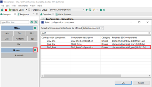

1. The first error encountered while building the model was related to a failure in the compilation process, due to the fact that multiple files with the same name are present in the sources list. The cause of this issue is represented by the usage of the Port component together with the Pins Tool inside your .mex (they both generate configuration files with the same names). MBDT integrates the RTD (Real-Time Drivers) package for enabling the on-board configuration inside S32 Configuration Tools. The Port component and the Pins Tool can't be used simultaneously inside a .mex file, due to the drivers limitations with respect to these components compatibility.
The feature of using the Port component together with the Pins Tool will be available in our next release, which will include a new RTD package version, where this issue was addressed.
Proposed Solution: Delete the Port component configuration by right clicking on it and selecting Remove, and add the Siul2_Port component from the Drivers categories. No other settings must be made inside the Siul2_Port component, as it will be used only for initializing the pins as configured in Pins Tool

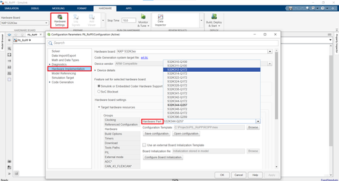

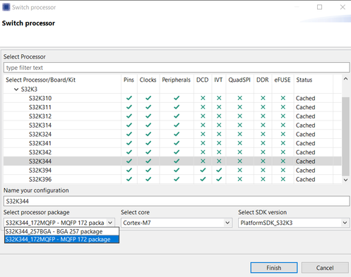

2. The .mex file is configured for the S32K312_100MQFP processor, while your model is set for an application targeting S32K344-Q172. There must be a match in the project configuration and the processor targeted by the Simulink model, otherwise errors will be thrown during the build process.
Now depending on which processor you are targeting, please choose the suitable approach for your use case from the ones mentioned below.
Proposed Solution 1: Change the S32K344-Q172 to S32K312-Q172 from the model's Hardware Settings - Hardware Implementation - Target Hardware Resources group - Hardware - Hardware Part widget. This step will reset your configuration template to the default S32K312-Q172 project the toolbox provides, so you would need to reselect your own Configuration Template by pressing the Browse button. Check also the selection of the blocks in the Simulink model after this process.
Proposed Solution 2: Change the processor used in the configuration by accessing File - Switch Processor from the S32 Configuration Tools menu. In the opened window choose the S32K344-Q172, as target by your model and perform your configuration updates.

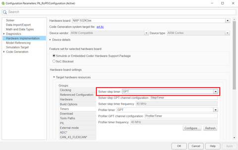

3. The MBDT models execute on target periodically, and this is implemented with the help of a timer. If you go to the Timers tab in the model's Configuration Parameters, you will see that the Step Timer used by the model is GPT. This timer is loaded with a configurable period and triggers an interrupt whenever the timeout is reached - inside its Interrupt Service Routine the application code is executed. However, in your associated .mex file the Gpt component is not configured, therefore, using this selection will cause the build to fail.
Proposed Solution 1: Change the model's Step Timer to SysTick (generic Arm timer which does need a .mex configuration).
Proposed Solution 2: Add Gpt component inside your .mex file and configure it appropriately - for reference you can check the S32K312-Q172 default project existent in <toolbox_root>/mbdtbx_s32k3/devices/S32K312-Q172/s32ds_default_project_config/s32k312-q172.mex.

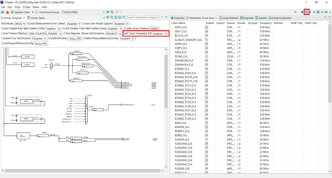

4. Get Clock Frequency API must be enabled inside the Clocks Tool for model's timing computation we perform in our toolbox.

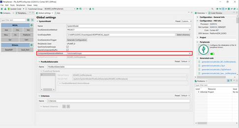

5. MBDT currently offers support only for FunctionalGroups as the ComponentGenerationMethod.

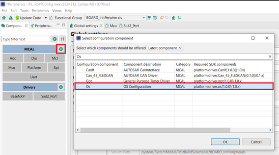

6. Os component needs to be enabled - no specific configuration needed - files from other components are requiring Os drivers.

    - used Siul2_Port instead of Port
    - enabled the Get Clock Frequency API
    - changed ComponentGenerationMethod selection to Functional Groups
    - added Os component

    - changed the model for the S32K312-Q172 Hardware Part
    - changed the model to use SysTick instead of GPT as the Step Timer
