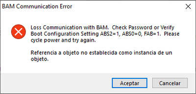

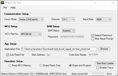

I have some trouble when I try to program my MPC5675K (custom board) via CAN. I am using RAppID BL Tool for that purpose (version 1.6.7.35) and as interface I tried with Vector's CANcaseXL and VN1630 with no luck.
In order to make things easier, I generated a basic program with some peripherals check (comms, IOs, ADCs, etc.). The .mot file was generated in Matlab with Motor Control Toolbox. Here is the configuration of RAppID.
And this is the message I get when I try to program the micro.
The ABS2, ABS0 and FAB pins are set by hardware as the message says. I also tried with different baud rates with no luck. Is there any detail am I missing?
