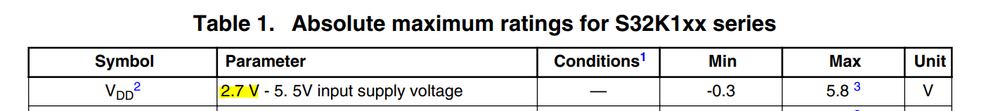

Basically, what I understand is that you are trying to measure time intervals, as long as the MC33772 is in sleep or completely off due to the undervoltage scenario, using the RTC timer on the S32K144.
If my understanding is correct, the S32K144 has to be still powered up, even if the MC33771 is not. So, according to the S32K Data Sheet the voltage has to be at least 2.7V in order to still use the RTC timer.
More than that, the RTC is Fully Functional in all the Power Running Modes of S32K.pastedImage_3.png
