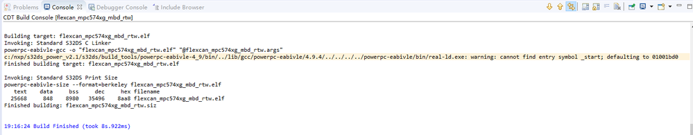

ysj1
hello Constantin Razvan Chivu,
I setup MBD toolbox 3.1.0 again , the flexcan_mpc574xg_mbd_rtwin  can bulid which is imported with ProjectInfo.xml in S32 Design Studio for Power Architecture2.1.
there are six errors:
Ld error: cannot specify -o with -c, -S or -E with multiple files     C/C++ Problem
make: *** [subdir.mk:110: core0_intc_sw_handlers.o] Error 1 flexcan_mpc574xg_mbd_rtw    C/C++ Problem
make: *** [subdir.mk:110: interrupt_vectors.o] Error 1 flexcan_mpc574xg_mbd_rtw    C/C++ Problem
make: *** Waiting for unfinished jobs.... flexcan_mpc574xg_mbd_rtw    C/C++ Problem
11,238 Views
constantinrazva
Hello [email protected],
That is an issue with the S32Design Studio - the workaround would be to rename all the .S files into .s [from capital S to lowercase s] - e.g.: startup_MPC5748G.S will be renamed to startup_MPC5748G.s
Let me know if you still encounter issues after this workaround.
Kind regards,
Razvan.

ysj1
Hello Constantin Razvan Chivu,
I uninstall MBD 3.2.0,and install MBD 3.1.0,build button can work.
as you say, rename all the .S files into .s.
In building, there is a warning: c:/nxp/s32ds_power_v2.1/s32ds/build_tools/powerpc-eabivle-4_9/bin/../lib/gcc/powerpc-eabivle/4.9.4/../../../../powerpc-eabivle/bin/real-ld.exe: warning: cannot find entry symbol _start; defaulting to 01001bd0.
Now, new .elf file is generated, download to EVB, can not run.
I do not know how to modify.
11,238 Views
constantinrazva
If you get that warning, the application will not start correctly, as it's entry point is being reset to some default location, instead of the correct function.
Can you let me know the exact steps you have done to get to this warning?
P.S.: you can install the 3.2.0, there is no need to go to an earlier version.
Kind regards,
Razvan.

ysj1
 In building process, show a warning :warning: cannot find entry symbol _start; defaulting to 01001bd0.
the possiable reason is that setting position of real-id.exe is wrong.
Buliding program seek from:c:/nxp/s32ds_power_v2.1/s32ds/build_tools/powerpc-eabivle-4_9/bin/../lib/gcc/powerpc-eabivle/4.9.4/../../../../powerpc-eabivle/bin/real-ld.exe.
but I do not find it .
