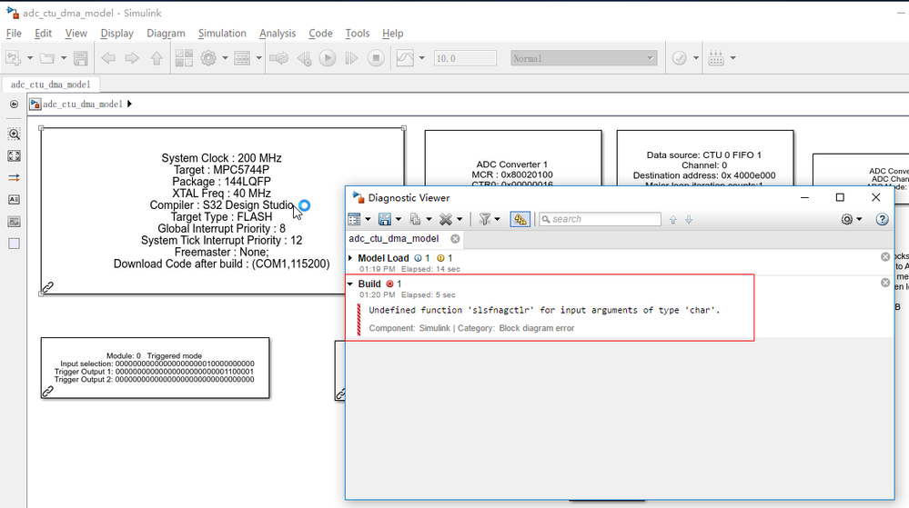

Dear engineer:
I install MBD Toolbox for MPC574xP ReleaseV2.0.0 in MATLAB R2017b.When I build an example,there was an error,"Undefined function 'slsfnagctlr' for input arguments of type 'char'".I do not know how to solve this problem,could you help me?

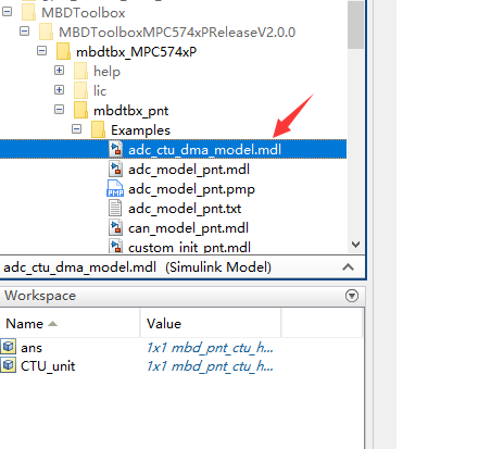

the example :

Hi yyang‌,
We know about this issue. The MATLAB has changed the slsfnagctrl() API in the 2017b release.
The toolbox for MPC5744P was released before MATLAB 2017b therefore we could not anticipated such changes.
Can you revert to a previous MATLAB release (2015a - 2017a) ?

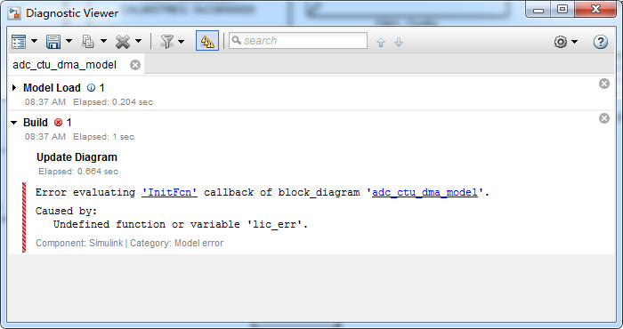

I have solved this problem  “Undefined function or variable 'lic_err' ” ,by replace the mbd_pnt_hostid.p file.

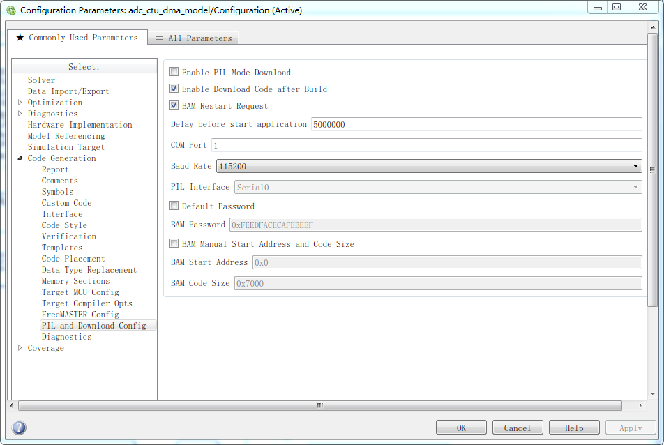

Now I have another question:
Can I use PE MULTILINK UNIVERSAL or Jlink to download the program to my target MCU(S32K or MPC7544P) in MATLAB ?

I try it in MATLAB R2015b,there is another Error .
I have applied a license from NXP website,and put the license file in lic folder.
