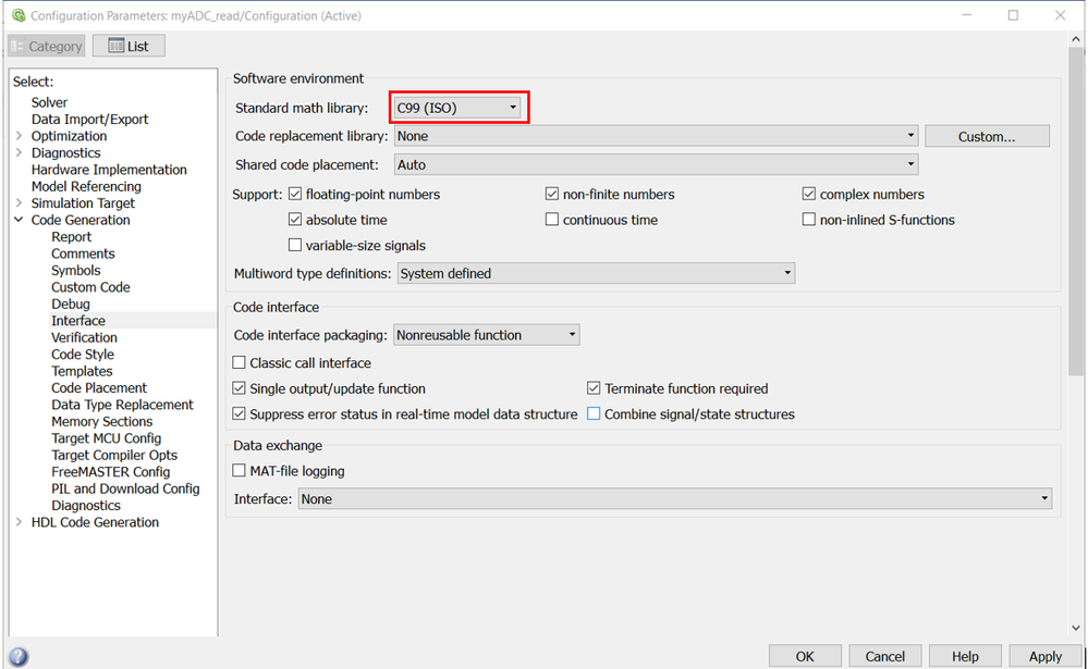

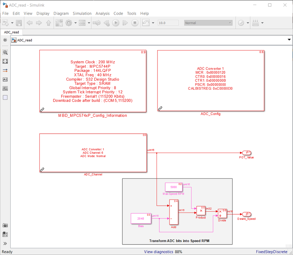

I am going over the excellent videos about Motor Control MBD with the MPC5744. Nevertheless, when I try to build the example shown in the screenshot above I get the following error:
            adc_pnt_library.c:293:5: error: expected expression before '/' token
            // while(ADC[adc_num]->MSR.B.NSTART == 0){}
            gmake: *** [adc_pnt_library.obj] Error 1
Although in the Target Compiler Opts of the Configuration block (please refer to screenshot) the system is calling out the C99 ISO standard, the gcc compiler is complaining about the double forward slash being used for comments.

mariuslucianand
Hello ernestoinoa‌,
The reason for your gmake error is that you are using the -ansi flag instead of -std=c99.
However from your log we observed that you have a lot of warnings and you are using a toolchain different that we do. In order to help you solving this, please send us an archive containing the model and the ADC_read_mbd_rtw generated folder.

ernestoinoa
Marius,
Thanks a lot for your reply.
In order to get C99 generated code I have to select this option for the standard math library, as shown below:
Nevertheless, when I do this the number of errors increases quite a bit. I am attaching the full log of the Code Generation from the Diagnostic Viewer of the model I am trying to build when C99 is selected for the standard math library, the model, and the mbd_rtw generated folder.

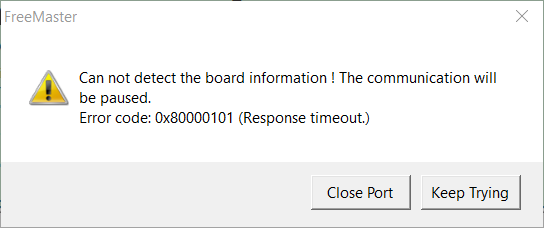

Now I am facing another problem, though.
When I try to read the potentiometer from the MPC5744P DevKit I get the following error:
To troubleshoot this issue I loaded the generated elf file with S32DS in Debug Mode, and looks like the program running in the target goes wrong after the System Timer Module gets enabled (instruction STM_0.CR.B.TEN = 1; in the generated C code). I am attaching a Microsoft Word file with screenshots of S32DS at every debugging step. I am also attaching my compilation result, in case it might help.

Daniel_Popa
Hi ernestoinoa‌,
S32 Design Studio 1.2 was released after we have release the toolbox 2.0.0 for MPC5744P. In the V1.2 of S32 DS the linker files were changed. Please apply this patch to make it work: https://community.nxp.com/thread/451804#comment-916493

ernestoinoa
Hello Dumitru,
Thanks a lot for your suggestion... it worked like a charm!
