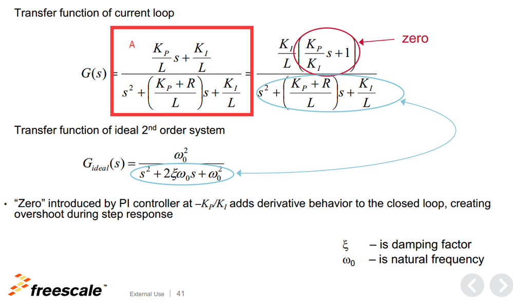

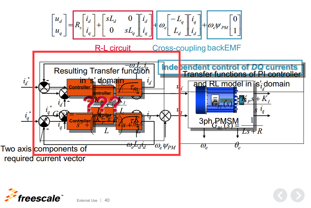

Stage 1: represent the closed loop control implementation. The QUESTION ??? is how to compute the controller parameters if you know the plant model?
Stage 2: Based on control system theory both the plant==motor electrical model==Grl(s) and the current controller==Gpi(s) are 1st order transfer functions
Stage 3: if you perform the computations shown in https://community.nxp.com/thread/450679#comment-904019
then you'll get the closed loop transfer function for each current loop.

#1:I download  the file that the link you sent me,and the content in the page 40 (shown as below),is not so clear  and there is some overlap.
and if you can send a clear file to me?
#2: I don't know how to deduce the transfer function in the Part  A (shown as below).

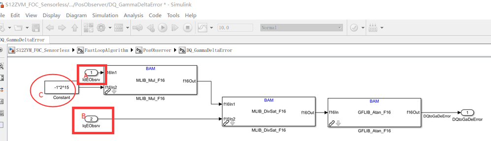

#3:About the model of S12ZVM_FOC_Sensorless,shown as below, i wanna make sure the IdEObsrv(Part A shown) and IqEObsrv(Part B shown) is EMF or not ?  i  thought is EMF, my reason ,EMF contains the position and speed of rotor, to get the Postion of the rotor using the arctan() Function,namely Theat=arctan(EAlpha/EBeta),
and there is another doubt that the -1*2^15 in Part C,why we multiplied the -1*2^15 with IdEObsrv?

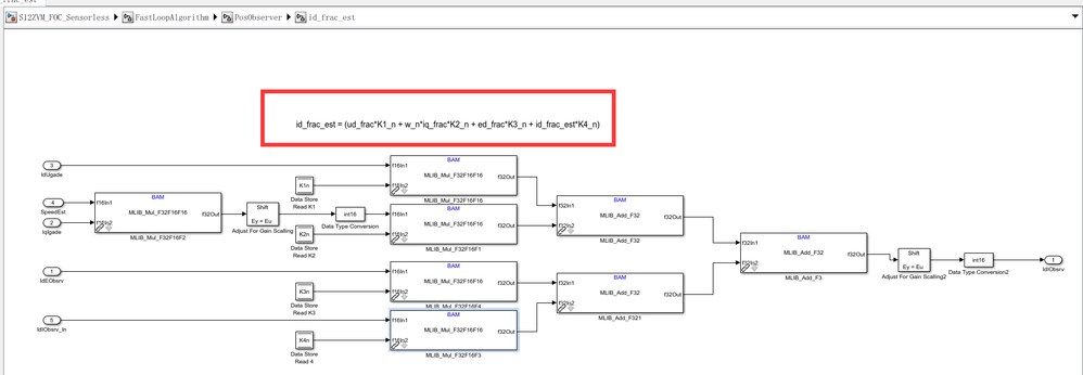

#4:Shown as below,how to deduce the id_frac_est = (ud_frac*K1_n + w_n*iq_frac*K2_n + ed_frac*K3_n + id_frac_est*K4_n)?
I don't know how to deduce it,and the id_frac_est  is deduced form  EMF?

For #2, that transfer function represents the closed loop computation for a first order RL system controlled via a PI controller (1st order)
Since it's quite a pain to write all the math in html i'm attaching a picture with computations. Please excuse my hand-writing.
