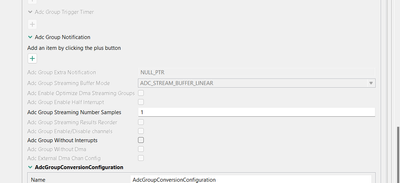

paul_ephraim_13

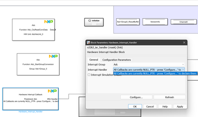

I unable to edit the Adc Group Extra notification, as they seem to be disabled ! kindly help!
I am config for a S32k312- Q172 evb and in the interrupt block it displays pointing to nullptr.
i tried to replicate this model using an example provided in the nxp website

Hi, @paul_ephraim_13,
First of all, I have some questions for you, namely, what is the reason for which you want to enable the Adc Group Extra Notification? What application do you want to implement so that you think you would need this feature? I ask to understand exactly what the use case is and the need to enable it, because this notification is implemented to be used simultaneously with the Adc_SetChannel API, a function that is currently not implemented in the ADC block.
It is possible that the functionality you want to implement does not necessarily require the use of this extra notification.
Keep us posted on your progress.
