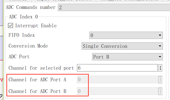

Hi ,Daniel
Now i am studying the demo CTU,
I am confusing the ADC commands in the CTU configuartion .
can you tell me how to Identify the difference between A and B ?
thank you very much.
best regards
hao

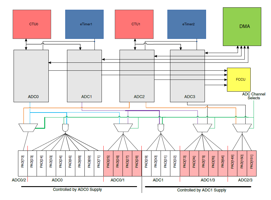

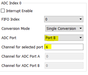

mariuslucianand
Hello [email protected]‌,
I will try to respond to this question.
The CTU is able to start either a single conversion or dual conversion.
In Single Conversion, the CTU triggers the Channel for selected port  6 from the ADC Port  B.
In Dual Conversion, the CTU can trigger two channels from different ADC peripherals. In this case channel 0 from ADCA and Channel 0 from ADCB. Obviously the ADC peripherals should be configured as in the ADC Config example block.
In order to identify which is the ADC Port A and ADC Port B for each CTU peripheral, you can consult the following diagram: basically the CTU0 can control the ADC0 (Port A) and ADC1(Port B) while the CTU1 can control the ADC2 (Port A) and ADC3 (Port B).
For more details, you can consult the Chapter 35: ADC Configuration from  the  MPC5744P Reference Manual https://www.nxp.com/webapp/Download?colCode=MPC5744PRM.
Hope this helps,
Marius

haoxue1027
Contributor V
hi ,Marius
thank you very much for replaying,
that is very helpful for me.
have a nice day,
best regards
hao

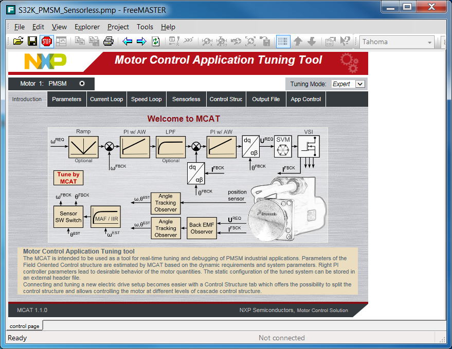

What about applications when we can't tune controllers at factory level and the tuning must be done in the field ?
In fact we have a tool like that called Motor Control Application Tunning (MCAT) which is part of the reference applications: S32K144 3-phase PMSM Development Kit|NXP . That might be a solution for tuning.
Can You show us (or at least mention) some good strategies for implementing automatic tuning in such cases ?
I personally used 2 methods - both of them quite reliable:
#1: measure directly system resistance&inductance and inertia&friction. This requires some special testing development routines. Base on these value measured, we can then compute the controller gains with simple pole placements or Ziegler-Nichols methods.
#2: system closed loop transfer function identification with white noise injection. First we inject an white noice as voltage command and we measure the current responses - and then we estimate the current loop transfer function.
With the current controller tuned - then we inject a white noise as current and measure the speed/position responses - and then we have the speed transfer function.
We can use these 2 transfer functions to tune the controllers for both slow and fast loops. Of course the second method is more complex.
