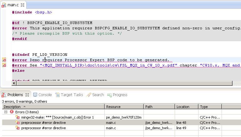

zalayeta_ye
hi David,
Thanks for your reply.
I do have tried the pe_demo. I got error "Demo requires Processor Expert BSP code to be generated" as the demo require "PE_LDD_VERSION" defined. But PE_LDD_VERSION is actually undefined in Freescale_MQX_4_0\lib\twrk60n512.cw10\debug\bsp\Generat_Code\PE_LDD.h file on my side.
I remember that in MQX3.8, there is PE bsp project for kinetis target, for example, bsp_twrk40x256_pe. All related PE header files will be copied to lib\twrk40x256.cw10\debug\bsp\Generated_Code folder automatically after I build the _pe bsp project. But there are no _pe bsp project in MQX4.0.

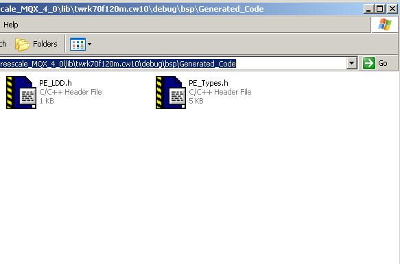

zalayeta_ye
hi Luis,
I added some components in bsp project and build the bsp project.
But there are no pe header files in Freescale_MQX_4_0\lib\twrk70f120m.cw10\debug\bsp\Generated_Code.Snap1.jpg
Then if I build the pe_demo_twrk70f120m, I got the error message as below:
4,324 Views

zalayeta_ye
hi Luis, Yes, I can see the files in bsp projects. But the pe header files, for example, GPIO1.h should be copied to the Freescale_MQX_4_0\lib\xxx.cw10\debug\bsp\Generated_Code folder automatically after building the bsp project. So that the application project can find these header files.
4,324 Views
LuisCasado
Looking at the bat file (postbuild step) bsp_twrk60n512.bat
It looks like the copy should be done:
for /R %MQXROOTDIR%\mqx\build\cw10\bsp_twrk60n512\Generated_Code %%f in (*.h) do copy %%f %OUTPUTDIR%\Generated_Code\
The old bat file (3.8) used :
copy /Y ..\..\..\mqx\build\cw10\bsp_twrk60n512\Generated_Code\*.h .\Generated_Code
copy /Y ..\..\..\mqx\build\cw10\bsp_twrk60n512\Sources\*.h .\Generated_Code
But files should be there after postbuild step.
